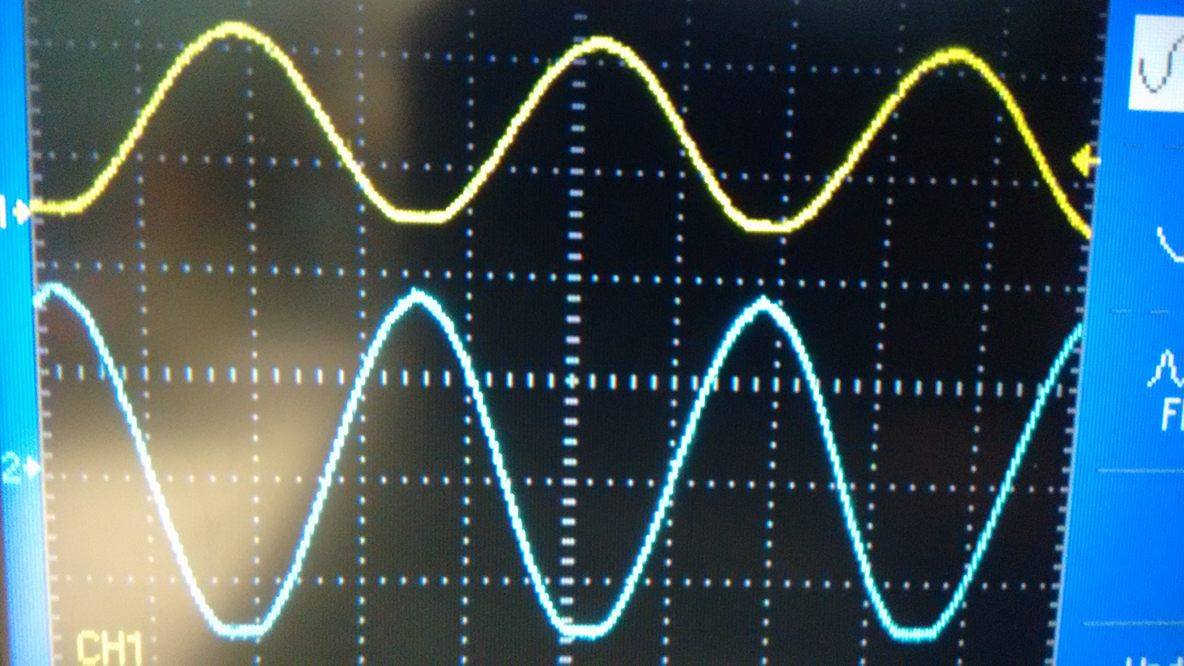

Fig 1: Clipped SPWM output after filtering (when dead band is used)

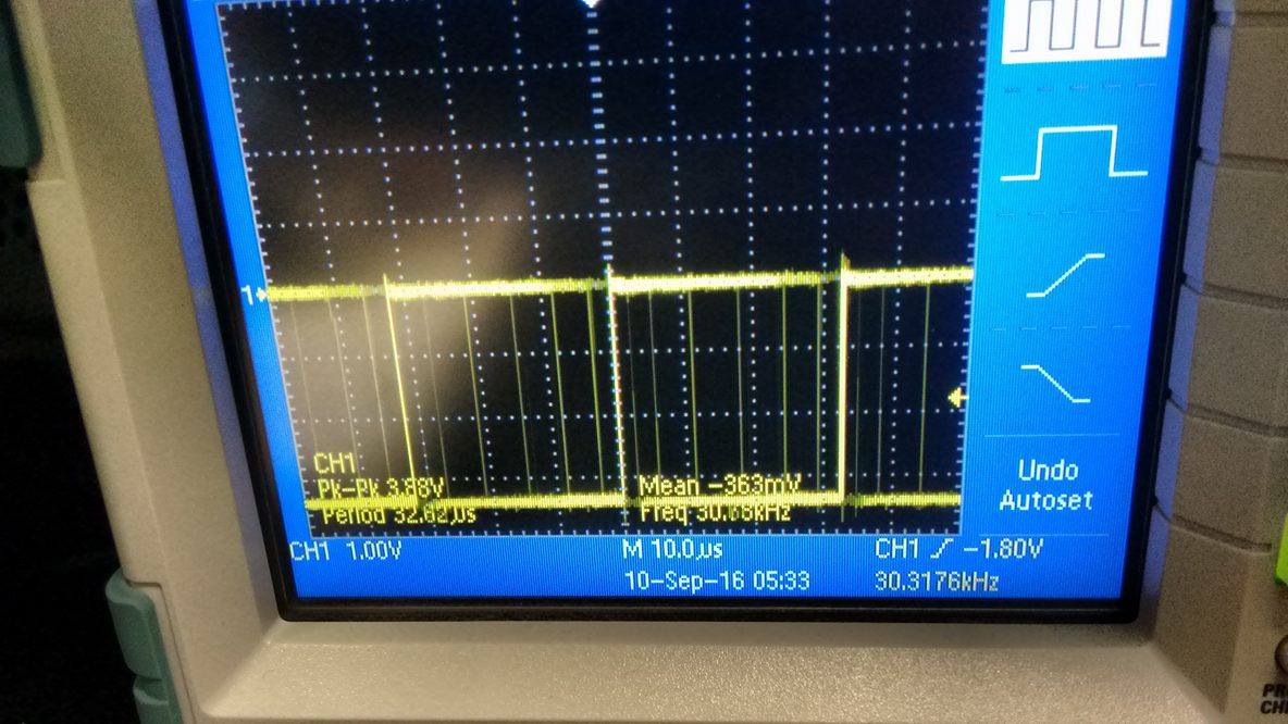

Fig 2: SPWM output without filtering (when dead band is used, frequency showing 26.542 Khz instead of 30 Khz)
Fig 3: SPWM output after filtering (without dead band)
Fig 4: SPWM output without filtering (without dead band, frequency showing 30.3176)

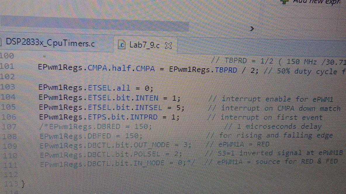

Fig 5: Code when I did not use dead band

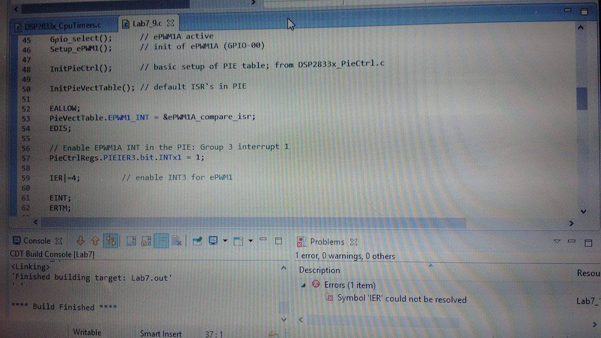

Fig 6: Error after debugging
  • Hi Sourov,
    Before we debug the PWM issue - i would like to make sure that the IER issue is resolved and ensure that the right application is running on the target.
    Can you look at the link below and see similar issues on IER discussed?
    e2e.ti.com/.../415381
    Try these options and let us know if you still see the PWM issue after resolving IER problem.
  • Hi Subrahmanya Bharathi,
    Thank you for your reply. When I restarted my OS, suddenly I found that there is no more IER error issues. But I am still facing all of my main problems except this IER error.

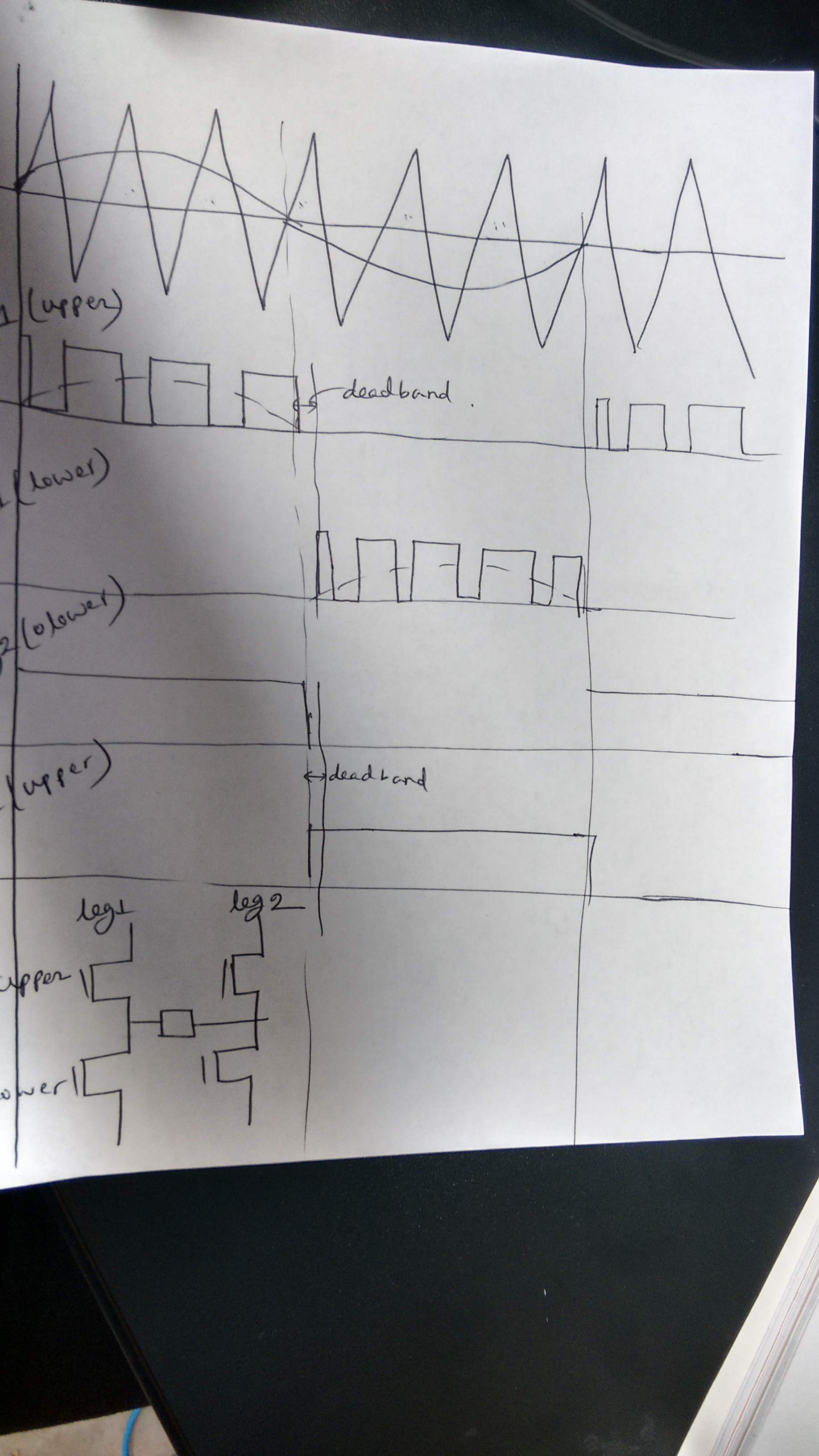

  • Actually I need this type of wave shapes for the different mosfets in a single phase inverter to inimize the switching loss (attached). Is there any kind of source code for sinusoidal pwm with dead band implementation?
    OK. Waveform above is not same as the active high complimentary.
    There is no example for this configuration that i know of.
    You have to develop software as per the requirement - but this wave form can certainly be achieved with epwm.
    You will have to control turn on and turn off of pwms in software.
