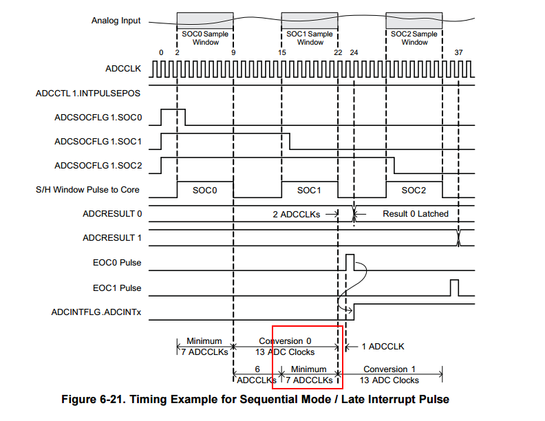

  • OK sorry we seem to keep talking past each other. Can you specify what conversion results you are getting when they are "dead on"? I am just trying to clarify whether you are using the results of (1) or actual expected conversion results based on the input voltage as "golden".
    It might also help us to know the following:
    * what you are using to force the voltage on the input?
    * are you measuring the voltage at the pin or trusting the source output reading?
    * is it buffered?
    * what ACQPS and ADCCLK settings are you using?
    * are you taking multiple samples and averaging or single conversions?
    Joe

  • We are getting close to concluding this exercise.
    While investigating this, we discovererd that one of the principal causes of noise in our system was the configuration parameter ADCNONOVERLAP.
    This parameter allows some (as far as I can tell, unspecified) overlap between the end of the sampling period and the start of the ADC conversion period.
    In the presence of a noisy signal, I can see that starting a pipelined ADC conversion while the input signal is changing could introduce additional errors into the ADC process.   I'm having difficulty understanding why you would ever want to have overlap between sampling and conversion.   Please can you answer the following questions:
    (1) Am I correctly understanding what the ADCNONOVERLAP register causes during the ADC cycle?
    (2) How much overlap between sample and conversion does clearing ADCNONOVERLAP to 0 cause?
    (3) Why would anyone want to have overlap between the sample and the convert cycles of a high speed ADC?
    Jeff
  • Hi Jeff,
    The architecture of the ADC for this device is "Hybrid pipeline / SAR".  The original design allowed some level of pipelining between the conversion phase of one conversion, and the S+H phase of the next conversion.  This is up to 7 ADCCLK cycles, and can be seen in the following timing diagrams:
    This architecture is theoretically fine; many high speed ADCs use a pipelined architecture (and almost all really high speed ADCs).  However, we have an errata for this device (first sample issue) which was solved by adding the functionality to allow the user to disable conversion pipelining (writing 1 to the ADCNONOVERLAP bit) and by setting the ADC clock speed to 30MHz.
    It is recommended to do your offset self-calibration with identical settings to whatever your application is going to use (so if you intend to enable the NONOVERLAP bit and run at 30MHz to avoid the 1st sample issue, these settings would be the best choices for also doing self-calibration).
