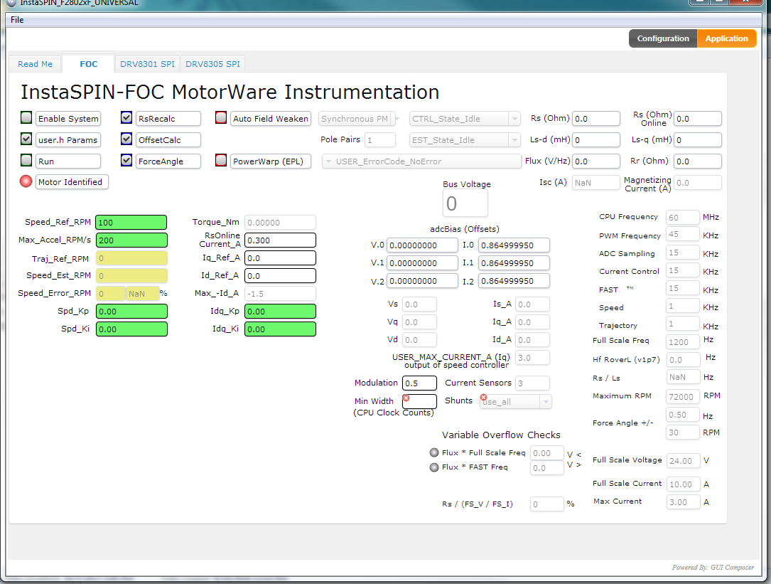

I want to run a 24 V  30K rpm bldc motor .I tried ID using program 5b,but during identification the RoverL is always equal to 2000.
And the motor sanity check failed for Rs/Ls.
according to GUI Quick Start guide Instaspin Universal ,I tried to attempt ID using lab 2c but still RoverL came around 12000.
The USER_R_OVER_L_EST_FREQ_Hz is already set at  300.
How should I go further ? Please help

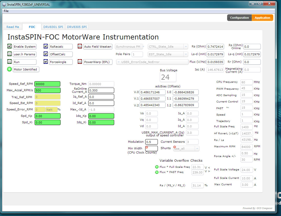

  • RoverL of 12000 is valid.
    using proj_lab02c to the ID process complete? did the motor start-up and keep spinning during the ID process?
    you are following the best guide
    attach your user.h if you like
  • also
    "The USER_R_OVER_L_EST_FREQ_Hz is already set at 300."
    USER_R_OVER_L_EST_FREQ_Hz is the frequency of the injected signal during RoverL test. It isn't related to the RoverL of the motor that is returned from the test.

  • With these values ,motor stops at flux calculation  and tries to regain back while calculating L. But the rotor doesn't revolve completely.It goes back and forth during calculation of L.
    right now the bias are
    v.0  1.55085242
    v.1 0.533664525
    v.1 0.532991469
    I.0 -0.868907452
    I.1 -0.863847375
    I.2 -0.865242541
  • there is something wrong with channel 0 on the voltage. It is completely different than the other two. I would check to see if the HW is somehow damaged.
  • If I connect f28069 control card on the same kit ,then all bias are same after 3 decimal places.So is there any problem with my f28027 control card?Will the parameters of motor taken from this card work for the f28027 card?

  •  I am getting Isc(A) as 146.67A. How should i reduce this?
  • you can't reduce this, it is a function of your motor design and is equal to flux / 2pi / Ls
    this value is displayed to give you a sense of the type of motor you are using
    you have a low flux, ultra low inductance machine. these are typically "hobby" style motors used for high speed applications. The currents are typically difficult to sense and more difficult to control.

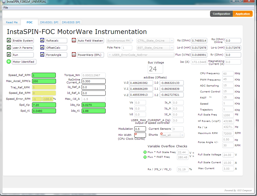

  • It worked after varying IqRef_A. In project 5b can't we vary the speed_Ref_RPM?whenever I write any value it is forced to 1.
  • 5a is torque control. there is no speed controller in software. you provide the torque reference, just like stepping on the pedal of a car.
    5b is speed control
  • Ya,but when I load parameters from user.h and hit Run the default speed 100 gets changed to 1 and motor doesn't  rotate.
  • now increase Iq_Ref_A per the InstaSPIN_labs.pdf directions
  • Sorry I forgot to tell you .5a is working great once we increase Iq_Ref_A.These images are regarding program 5b,I am unable to vary the speed.
  • the speedref shouldn't change to 1. it won't change?
    are you sure you didn't change the source code for 5b? you may want to reinstall and use fresh source files
  • I have just commented "low_ctrlFreq_Hz" section condition in user.c .I will try with a fresh install and see if it works.
  • Yes it worked. Thank you very much .
