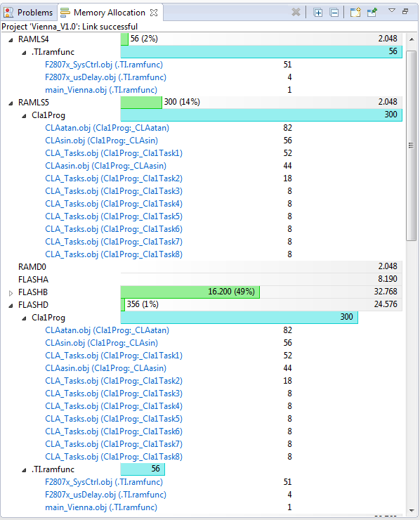

Hi Guys,
CCS v 6.2(compiler version = TI v15.12.3.LTS)
TMX320F28075 Control Card
control Suite v 3.4.1
RAMLS3, 4 and 5 are configured as CLA Program Memory. I was checking the Memory Allocation and found that Cla1Prog and .TI.ramfunc are repeated. (present in both RAM and FLASH)
Is this normal or have I configured it wrong?
