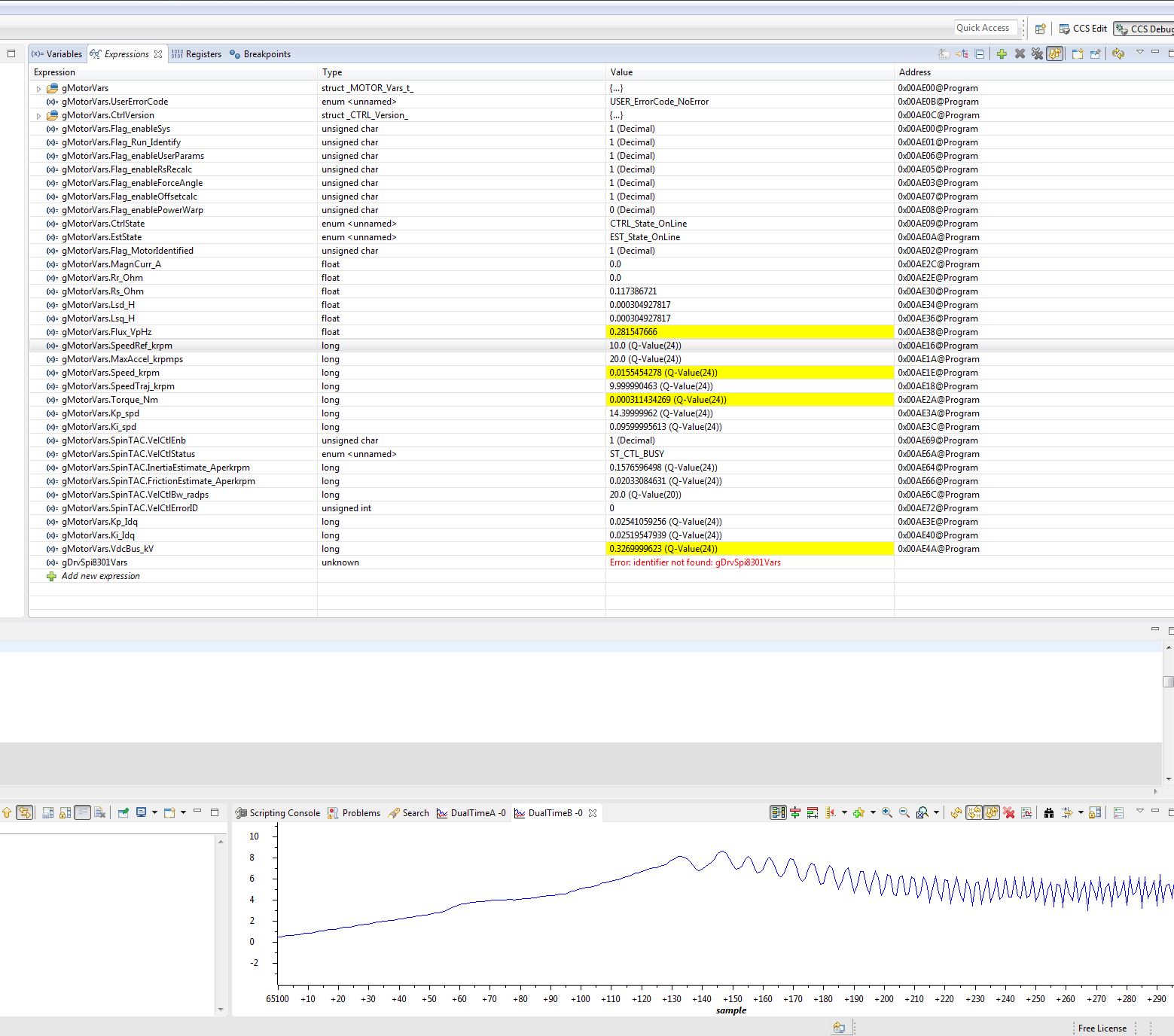

    The behavior that I am seeing is that the motor just stops without any effect to the gMotorVars structure. I have included a screen shot of the gMotorVars structure as well as a graph of Iq.  When this occurs I am unable to re-start the motor unless I exit the debug session and start over, and then the controller will run the motor again.
  • Have 3 questions as below.
    1. Can the traditional PI controller work well on the same platform?
    2. Did you set correct inertia for the SpinTAC speed controller? or use lab5c to do inertia identification?
    3. Why the gMotorVars.SpinTAC.VelCtlBw_radps is equal to 0? You need to set gMotorVars.SpinTAC.VelCtlBw_radps to _IQ(10.0) to _IQ(80.0) based on requested response. You can set "#define USER_SYSTEM_BANDWIDTH (20.0)" in user.h.

  • 1. The traditional PI controller acts the same way as the spintac in that the blender stops running when Iq approaches the limit.
    2. Yes, I did go through lab5c to the do the inertia identification.
    The USER_SYSTEM_BANDWIDTH is set to 20.0
