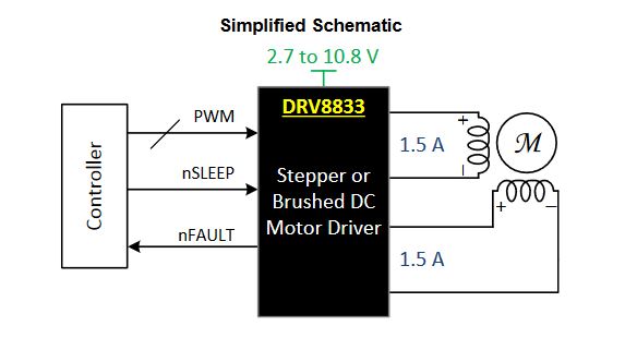

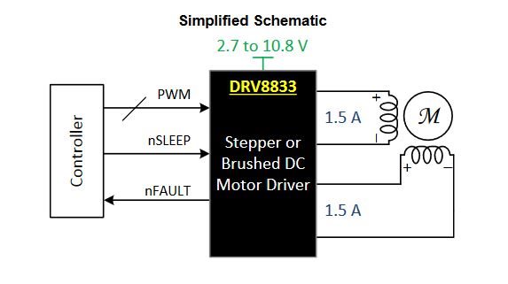

    DRV8833 can drive 2 motors with PWM, nSLEEP and nFAULT  connections. Secondly depends on your application how many PWMs you want to configure to realize this. Go through the driver datasheet thoroughly.
    F28377s has 24 PWM channels that you can configure. So you've no limitations for setting up 10 motors.
