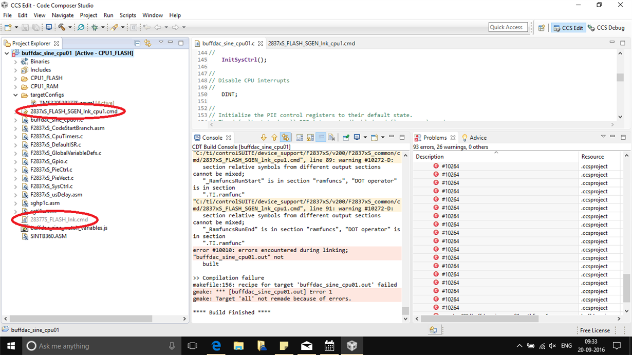

I am using CCS 6.1.3 installed on Windows 10 and the latest Controlsuit version. I am trying to run the DAC Sine Wave Generation project from the controlsuit on the TI F28377S control card. When I load the project, by default it is set to RAM instead of Flash so I changed it to flash by right clicking on the project and setting build options. When I built the project I got 87 errors without any description of what the errors are about. So I am attaching a screenshot with this post.
  • Hi Nikhil,
    I see two flash linker files in your project. The buffdac_sine example builds with "2837xS_FLASH_SGEN_lnk_cpu1.cmd" linker file. Remove "28377S_FLASH_lnk.cmd" linker file from your project, clean and try the build again.
  •  I excluded the '28377S_FLASH_lnk.cmd' from the build and added '2837xS_FLASH_SGEN_lnk_cpu1.cmd' but I still have the same problem.
  • Okay so I removed the "28377S_FLASH_lnk.cmd" file and also the "2837xS_FLASH_SGEN_lnk_cpu1.cmd" file that I had added and now it builds properly without any errors. Where do we see which .cmd file is associated with the project in the Project Explorer window?
    I do have about 10 warnings #10190-D and #10272-D without any description of what these warnings are.
    Does CCS take care of .cmd files in all projects? If not, how do we determine which cmd file to link to our project?
