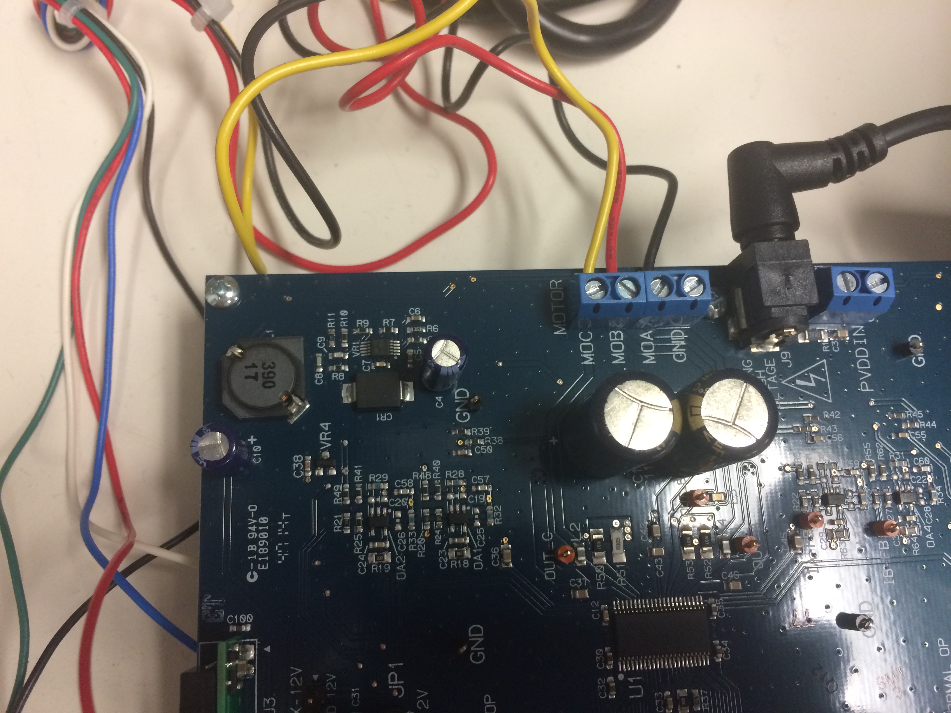

I am running DRV8312 C2 kit and I am trying to run sensored_BLDC example project. But in level 4, the motor stalls after rotating for half circle. The mod1.counter changes very slowly but the motor does not rotate. Did anyone met the same problem? How could I solve this problem. The hall sensor and motor are connected following the document as showing in figures below.
I have successfully run the BLDC_sensorless example. But I cannot run the sensored_BLDC example. The motor will stall after level 3.  And in level 3, the current offset does not make any change. But in the level 3 of BLDC_sensorless example, the current offset does change to around 0.5031.
Is there any wrong with the example? I bought the TI kit and really hope to let it work quickly. Could any engineer from TI or someone used it before help me with this problem?
