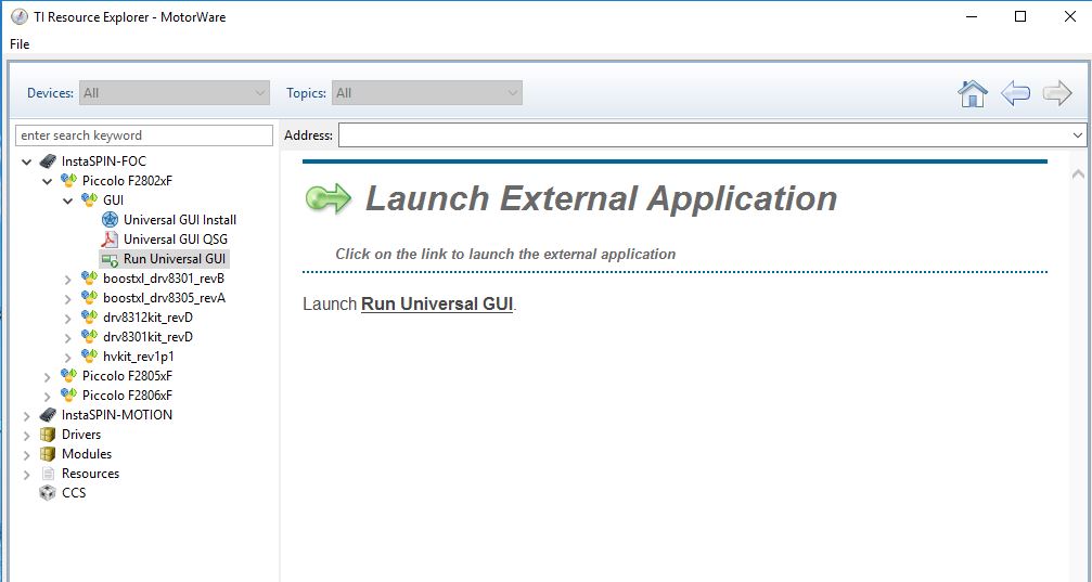

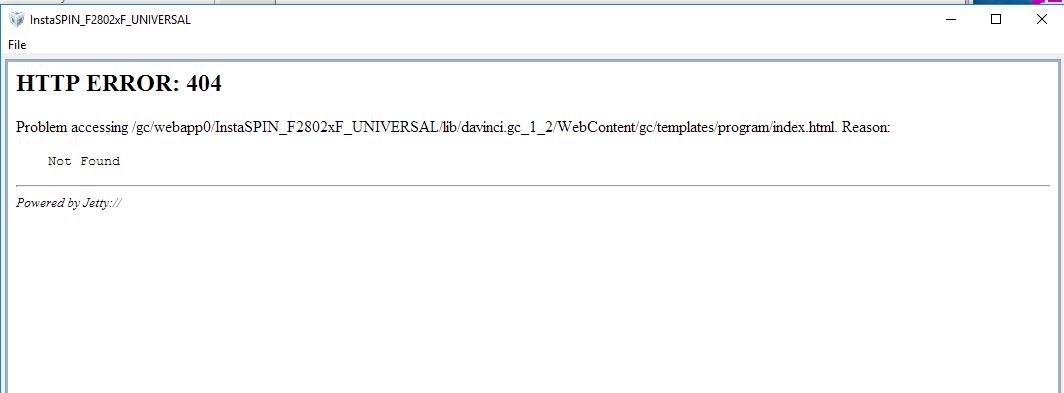

I am running all new installation on windows 10 and GUI doesn't work for me
see below:
And then I get this:
Why?
Roee
  • I saw a similar complaint to this recently
    let me move your thread to the GUI Composer team on the CCS forum

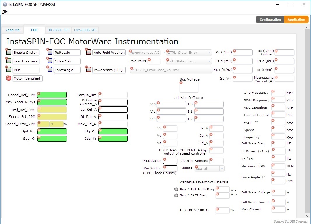

    I did un-install to all CCS environment and TI and re-installed
    This fixed the problem
    But I can't RUN GUI because there is no .out file to the WEB application of the Motorware
    See below - I open Motorware
    And then I get this
    And GUI is BAD - since no out file -> how should I get it? I want general 3-phase motor RUN
    Thanks for any help
    If the file was OK I wouldn't have all the red marks
  • per the user guide you need to create a .out in CCS using MotorWare and the projects for your inverter and controller combination
  • now that you got the GUI to work I'll move this back over to InstaSPIN forum

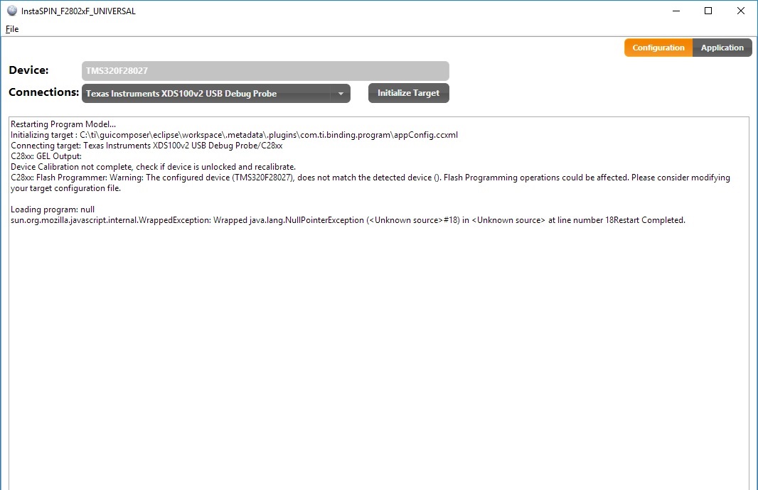

  • And then I get this:
    Restarting Program Model...
    Initializing target : C:\ti\guicomposer\eclipse\workspace\.metadata\.plugins\com.ti.binding.program\appConfig.ccxml
    Connecting target: Texas Instruments XDS100v2 USB Debug Probe/C28xx
    C28xx: GEL Output:
    Device Calibration not complete, check if device is unlocked and recalibrate.
    C28xx: Flash Programmer: Warning: The configured device (TMS320F28027), does not match the detected device (). Flash Programming operations could be affected. Please consider modifying your target configuration file.
    Loading program: C:\ti\guicomposer\webapps\InstaSPIN_F2802xF_UNIVERSAL\appProgram.out
    C28xx: GEL Output:
    C28xx: Loader: One or more sections of your program falls into a memory region that is not writable. These regions will not actually be written to the target. Check your linker configuration and/or memory map.
    C28xx: GEL Output:
    Which unlocked ??
    although I have taken all defaults in example and did not change anything
    Roee

    Also when I put the output file and run it I get this:
    C28xx: GEL Output:
    C28xx: GEL Output:
    meaning the device doesn't match
    where do I configure the C2000 board ?

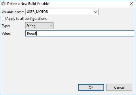

    Found and declare this:
    #elif (USER_MOTOR == Roee1)
    #define USER_MOTOR_TYPE BLDC
    #define USER_MOTOR_NUM_POLE_PAIRS (6)
    #define USER_MOTOR_Rr (NULL)
    #define USER_MOTOR_Rs (0.4110007)
    #define USER_MOTOR_Ls_d (0.0007092811)
    #define USER_MOTOR_Ls_q (0.0007092811)
    #define USER_MOTOR_RATED_FLUX (0.03279636)
    #define USER_MOTOR_MAGNETIZING_CURRENT (NULL)
    #define USER_MOTOR_RES_EST_CURRENT (1.0)
    #define USER_MOTOR_IND_EST_CURRENT (-1.0)
    #define USER_MOTOR_MAX_CURRENT (5.0)
    #define USER_MOTOR_FLUX_EST_FREQ_Hz (20.0)
    I think this is enough to start.
    Now how do I compile with my flag ? (Roee1)
    Roee
  • Roee,
    you are making progress. Keep reading the InstaSPIN_labs.pdf document
    you need to build proj_lab02c with your changes to user.h
    you will then load to your Launchpad using CCS and change the flags/variables using the CCS Expressions View to start the ID process.
    Once you have proven that work we can look at getting the INSTASPINUNIVERSALGUI to work correctly.

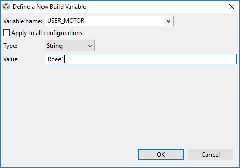

  • Ok,
    Where is the Build logfile is it here:
    C:\ti\motorware\motorware_1_01_00_16\sw\solutions\instaspin_foc\boards\hvkit_rev1p1\f28x\f2806xF\projects\ccs5\proj_lab02c\Release
    the XML file: proj_lab02c_linkInfo
    I did put variable here:
    But in XML file I don't see my variable Roee1 why ?
    Can I try to upload this now to webapplication ?
    Also how do I know that this lab is good for F28027F chip ?
    Roee
  • what in the world are you trying to do?
    have you considered following the instructions? They don't mention anything about creating a new build variable or touching an xml file.
    F28027F is InstaSPIN-FOC enabled. InstaSPIN-FOC projects are built using MotorWare. If you have a LAUNCHXL-F28027F and BOOSTXL-DRV8301 you will use the projects at:
    C:\ti\motorware\motorware_1_01_00_16\sw\solutions\instaspin_foc\boards\boostxldrv8301_revB\f28x\f2802xF\projects\ccs5

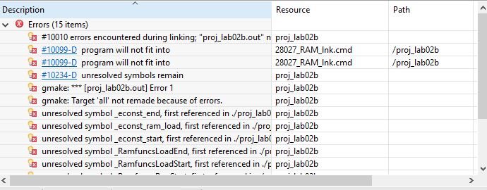

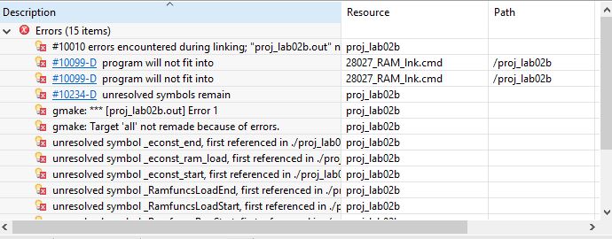

  • Ok,
    Almost read everything
    Now I am sure I am doing ok.
    However when I build I get errors:
    Most of them that program will not fit ??
    I did change in the build section to my device which is TMS320F28027F (that BTW is not in the list ??!)
    Any way I get errors of program will not fit ?
    Should I change this ?
    Roee
  • don't change any build settings.
    just follow the instructions.
    import the project.
    update the user.h
    build the project, launch debugger, and connect to target
