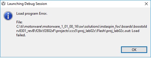

Problem to load appProgram.out to C:\ti\guicomposer\webapps\InstaSPIN_F2802xF_UNIVERSAL\InstaSPIN_UNIVERSAL
When trying to use this execute I get errors:
telling me that device might be locked
Can someone test my output file on
C2000 launchpad with DVR8301 just to make sure that my file is loading OK ?
The file is attached here
RoeeappProgram.zip
  • yes it loads fine for me
    you should see if you can connect to your Launchpad through CCS. if you get a similar error than you may have damaged/locked your Launchpad and need to replace it.
    if you can connect in CCS you should uninstall and reinstall the GUI

  • use CCS to see if you can connect to the Launchpad and load the code.
    per the instructions - once powered - select your project and hit the BUG icon.
    it should build, connect, and load.

  • per our direct messaging discussion, you didn't remove the jumpers on the Launchpad per the instructions
  • Sure I did remove -> zoom in the picture
    Jumper is on one pin -> therefore disconnected
    I don't want to loose them
    Roee
  • now put on the boosterpack and provide power to the boost. it will power the launch.
    that's how you run the projects and you should be able to connect to the target in CCS.

    I am 99.9% that the board is damaged by the LOCK
    I have another board somewhere in my house I will search for it tomorrow
    And will update -> but I am almost convinst that the board is damaged
    BR,
    Roee
  • I was right!
    Took the new board and everything is working!!!!
    This was all about the board - and I have no idea how it come broken ??

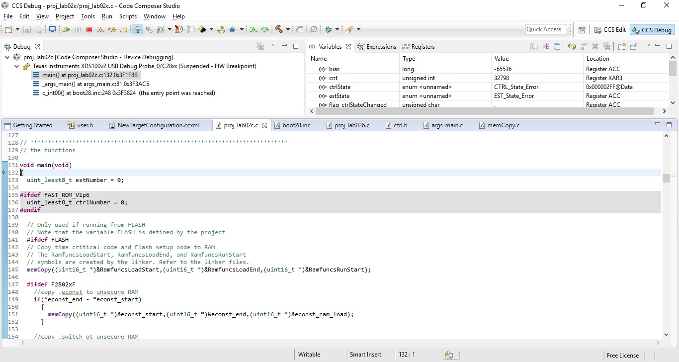

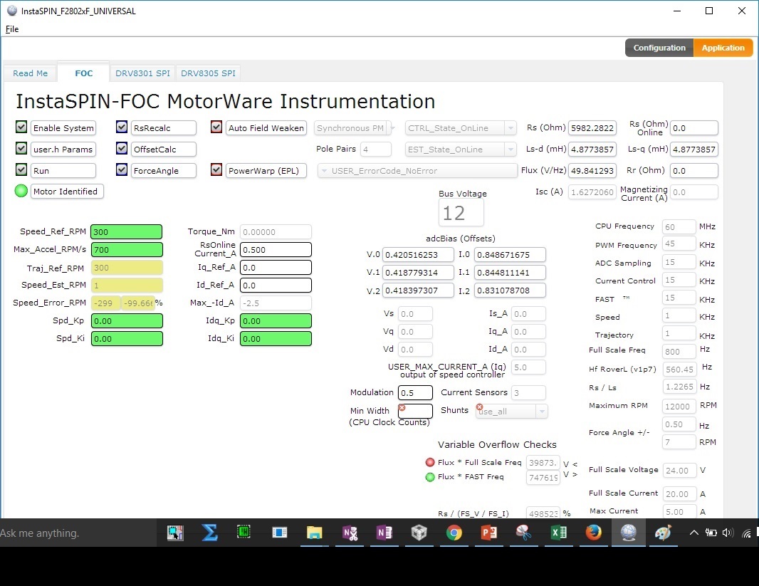

    Chris, after compiling and .out file is working however - I have configured to 6 poles, and when WEB application is opened it shows only 4 POLES in gray why ??
    Also when running from- CCS and loading - it is OK now but it jumps to start of the program and the motor is not spinning (not from GUI composer webapplication).
    Where is the point in SW that it should start - and how do I control it via Debug screen ?
    When using the Webpplication from GUI composer:
    The motor is not running smooth, after choosing "Enable" and "RUN" it wait for few seconds, and then doing some stuff, and spinning but not as I expected.
    Now I know that the SW should measure the motor automatically ??

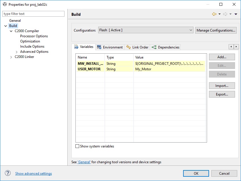

    If I am on my project and choose:
    show build settings
    on build variables I have added:
    variable:
    USER_MOTOR
    In order that it will be compiled with my settings on:
    user.h file
    The settings that I have chosen are:
    #elif (USER_MOTOR == My_Motor)
    #define USER_MOTOR_TYPE                 BLDC
    #define USER_MOTOR_NUM_POLE_PAIRS       (3)
    #define USER_MOTOR_Rr                   (NULL)
    #define USER_MOTOR_Rs                   (0.3918252)
    #define USER_MOTOR_Ls_d                 (0.00023495)
    #define USER_MOTOR_Ls_q                 (0.00023495)
    #define USER_MOTOR_RATED_FLUX           (0.03955824)
    #define USER_MOTOR_MAGNETIZING_CURRENT  (NULL)
    #define USER_MOTOR_RES_EST_CURRENT      (10)
    #define USER_MOTOR_IND_EST_CURRENT      (3)
    #define USER_MOTOR_MAX_CURRENT          (20.0)
    #define USER_MOTOR_FLUX_EST_FREQ_Hz     (100.0)
    BTW this is Segway  3 phase Motor
    Now if I am copiling it will create FLASH (.out) file with my settings is this correct?

    And not though the BUG window -> because I don't know yet how to make it run the motor (Although when using the Bug the program does flash now ok and I am in debug window - > on main -> and debugger waits for my commands
    (I guess that on real time I can change parameters vaules)
    So basically it run the same just without GUI - is this correct?

  • "on build variables I have added:
    variable:
    USER_MOTOR
    WHY?? Where in the documentation does it EVER tell you to do this?
    I can't help you if you won't follow the directions.
  • I have read it
    I see now this on user.h
    so In order to make it work I need to add this line:
    #define USER_MOTOR My_Motor
    correct?
    and BTW all the GUI are vaules that are taken from the compiled SW - meaning variable from TI SW that I can control in real time ?
    R
  • yes, like the instructions say you must define which USER_MOTOR is active.
    yes, GUI variables are just variables in code that you can either change or are reported
    you sent me a video of the motor running, so it seems you have passed the motor ID, have good parameters, and know how to load those values into the controller directly, bypassing motor ID. Well on your way.
    good luck.

    How can I run the motor without the GUI, I have seen how to start where is the Enable System and Run command in code?
    The GUI run the motor only for few seconds and stop - is this also set in code and where ?
    Thanks!
    Br,
    Roee
  • as mentioned in direct message
    you will have to update the software to set the flags as appropriate once it's running
    however, to change a speed you will need to have some way to communicate with your motor controller. this would require having an analog input from a pot, GPIO from push buttons, or serial communications from another processor, terminal, etc.
    Meaning you have to write SW for these purposes, and write SW for all of your system tasks. The InstaSPIN enabled Launchpad is not a motor driver PRODUCT. It is a development platform to build YOUR PRODUCT. There is still much work left to be done.
