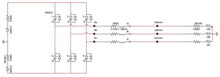

Open Loop Two Level Inverter Synchronization
I am trying to interface the F28069 as a controller for a simulated 2 level inverter.
The voltages and currents coming from the simulated two level inverter are per-unitized, offset and scaled to fit within the 0-3.3V input voltage range of the ADC. The F28069 should preform some control algorithm using these voltages and currents and generate the corresponding firing pulses to fire the 6 switches of the bridge using the ePWM modules.
I'm trying to preform a simple open loop test where the controller completely neglects the incoming voltages and currents from the simulation and simply preforms sinusoidal PWM for a fixed modulation index. The value of the modulation index (between 0 and 1) corresponds to the peak value of the sinusoidal modulation waveforms.
I wrote a simple function called Three_Phase_Sinusoid() which generates three phase sinusoids by first generating a peroidic sawtooth waveform from 0 to 2pi, which is then used as the argument to generate a set of three phase sinusoids.

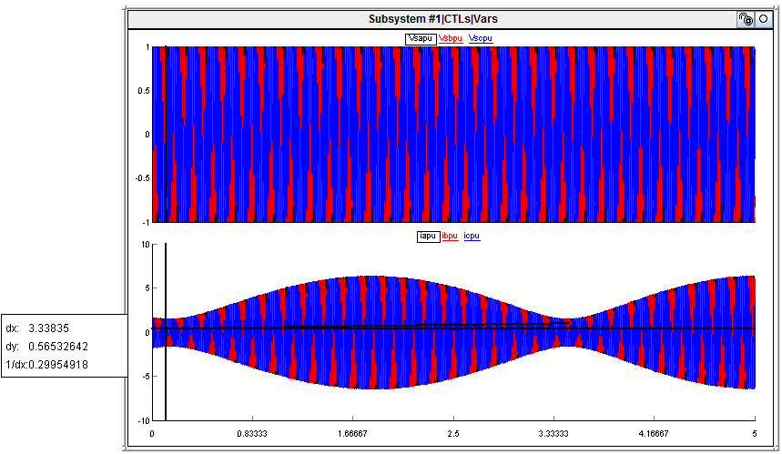

When I run the simulation and the controller, there appears to be low frequency oscillation between the simulation and controller. The simulation outputs new voltages and currents every 100us, and I believe I configured the ADC to trigger every 100us via ePWM7, so I would expect the two to be in synch with eachother.

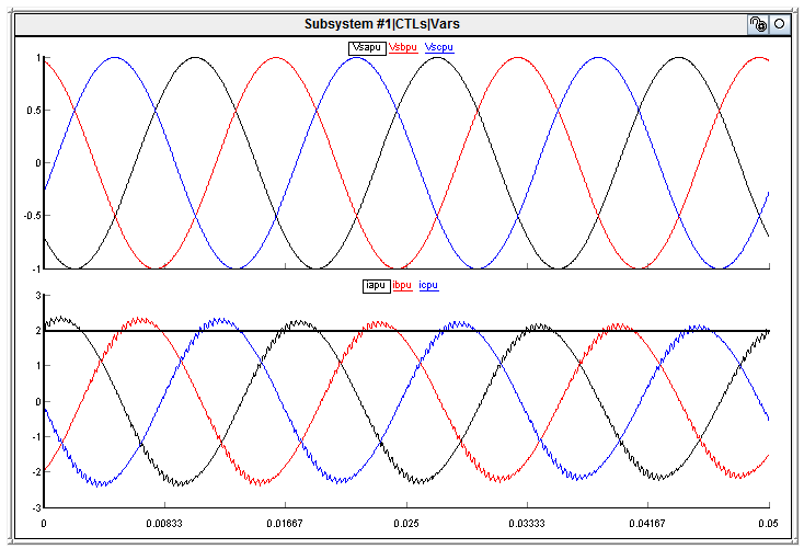

Here are what the expected waveforms for the voltage and current look like (using a simulated controller),
And here is the low frequency oscillation I observe when the F28069x is acting as the controller,
Zoomed in plot of waveforms,
Does anyone have any ideas what the problem could be? My guess was that the execution of the F28069x is not synchronized or executing at a different rate than that of the simulation.
Any ideas?

        EPwm3Regs.CMPCTL.bit.LOADBMODE = CC_CTR_ZERO; // load on CTR=Zero
        EPwm3Regs.AQCTLA.bit.CAU = AQ_CLEAR;                  // set actions for EPWM2A
   EPwm3Regs.AQCTLA.bit.CAD = AQ_SET;
        EPwm3Regs.DBCTL.bit.IN_MODE = DBA_ALL;               // EPWM1A is the source for both falling-edge and rising-edge delay
        EPwm3Regs.DBCTL.bit.OUT_MODE = DB_FULL_ENABLE; // Both the falling-edge delay (FED) and rising-edge delay (RED) are applied to the input signals
        EPwm3Regs.DBCTL.bit.POLSEL = DB_ACTV_HIC;             // Active Hi complementary
        EPwm3Regs.DBFED = FED_delay;                                 // FED
        EPwm3Regs.DBRED = RED_delay;                                 // RED
        // configure PWM modules (EPwm7 is being used as ADC clock source)
        // Assumes ePWM7 clock is already enabled in InitSysCtrl();
        EPwm7Regs.ETSEL.bit.SOCAEN     = 1;                   // Enable SOC on A group
        EPwm7Regs.ETSEL.bit.SOCASEL    = 4;                   // Select SOC from CMPA on upcount
        EPwm7Regs.ETPS.bit.SOCAPRD     = 1;                   // Generate pulse on 1st event
        EPwm7Regs.CMPA.half.CMPA       = 0000;                // Set compare A value
        EPwm7Regs.TBPRD                       = 8000;        // Set period for ePWM7: (4000 = 50uS in Count-up mode)
        EPwm7Regs.TBCTL.bit.CTRMODE = TB_COUNT_UP;    // count up and start
        EPwm7Regs.TBCTL.bit.HSPCLKDIV = TB_DIV1;
        EPwm7Regs.TBCTL.bit.CLKDIV = TB_DIV1;
// Wait for ADC interrupt
   for(;;)
        asm(" NOP");
interrupt void adc_isr(void)
static volatile Uint16 GPIO34_count = 0;           // Counter for pin toggle
GpioDataRegs.GPBCLEAR.bit.GPIO32 = 1;
out_buffer[j] = AdcResult.ADCRESULT0; // store sample in buffer
j++; // increment buffer counter
if (j == BUFFERLENGTH)
        j = 0;
Three_Phase_Sinusoid(&V);
fADC0 = (float)(AdcResult.ADCRESULT0);
fADC1 = (float)(AdcResult.ADCRESULT1);
fADC2 = (float)(AdcResult.ADCRESULT2);
// fADC3 = (float)(AdcResult.ADCRESULT3);
// fADC4 = (float)(AdcResult.ADCRESULT4);
// fADC5 = (float)(AdcResult.ADCRESULT5);
fADC0 = fADC0 * fPUscale;
fADC1 = fADC1 * fPUscale;
fADC2 = fADC2 * fPUscale;
fADC3 = V.fa;
fADC4 = V.fb;
fADC5 = V.fc;
// Drive PWM modules
dutyA = (Uint16)(((FP_VALUE)(period)) * (fADC3 + 1.0) * 0.5);
dutyB = (Uint16)(((FP_VALUE)(period)) * (fADC4 + 1.0) * 0.5);
dutyC = (Uint16)(((FP_VALUE)(period)) * (fADC5 + 1.0) * 0.5);
EPwm1Regs.CMPA.half.CMPA     = dutyA;
EPwm2Regs.CMPA.half.CMPA     = dutyB;
EPwm3Regs.CMPA.half.CMPA     = dutyC;
if(GPIO34_count >= 999)                                    // Toggle slowly to see the LED blink
        GpioDataRegs.GPBTOGGLE.bit.GPIO34 = 1; // Toggle the pin
        GPIO34_count = 0;                                            // Reset the counter
else
      GPIO34_count++;
AdcRegs.ADCINTFLGCLR.bit.ADCINT1 = 1;              //Clear ADCINT1 flag reinitialize for next SOC
PieCtrlRegs.PIEACK.all = PIEACK_GROUP1;   // Acknowledge interrupt to PIE
GpioDataRegs.GPBSET.bit.GPIO32 = 1;         // measure total execution time
return;
void Three_Phase_Sinusoid(Three_Phase_Sinusoid_Component *this){
        this->y = this->y_prevdt + 6.28318530718 * dt * this->freq + this->phase;
        if(this->y > 6.28318530718)
               this->y -= 6.28318530718;
        if(this->y < 0)
               this->y += 6.28318530718;
        this->y_prevdt = this->y;
        this->fa = this->fpeak*sin(this->y);
        this->fb = this->fpeak*sin(this->y - 2.09439510239);
        this->fc = this->fpeak*sin(this->y + 2.09439510239);
