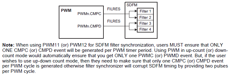

Hi Guys,
In F28075's TRM it is mentioned as:
Here how can I make sure that only one CMPC or CMPD event per PWM cycle is generated in Up_Down count mode?

Hi Manoj,
I am using all 8 SD FIlters. So I need to generate one CMPC and one CMPD event in ePWM11 and respectively in ePWM12.
It seems with INTSEL, I can choose only one event(either CMPC or CMPD). Or is it possible to generate both event once in a time period in UP-Down count mode?
Also, is it possible to force these events via software, so that I can read the value and then reset the DOSR?
