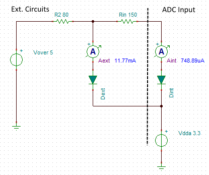

    Now instead of picking a diode with extremely low Vforward, you can actually pick one that is more similar to the internal protection diodes if you use this topology:
    In the simulation above, both the internal and external diodes use the same model.  You can see that by adding "Rin" after the diode, but before the ADC input, most of the current is steered into the external protection diode.  This is because the voltage drop across the internal diode + Rin must be the same as the drop across the external didode. Since the diode current is exponential with voltage, the voltage drop across Rin exponentially decreases the current steered through the internal diode vs. external diode.  R2 is used to limit the current through the external diode.  This still adds some series R, so the S+H window may still need to be slightly increased.
    Using this topology, you can pick a schottky diode (or even a normal silicon diode) with a much less aggressive Vforward spec'.  This will hopefully allow you to control the leakage current to a more manageable level.
