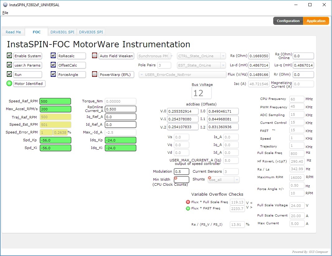

    4. In the main loop I see I need to get and set these parameters?
    Also earlier labs -> shouldn't they show me these values by measuring actual parameters from Motor ?
    When trying to change them  (Ki and Kp Manually) I got this:
    And since The Motor is in close loop spinning perfectly so I can estimate that the values in the window are accurate.
    BTW when running few times some of parameters change ..... (so measure is not the same....)

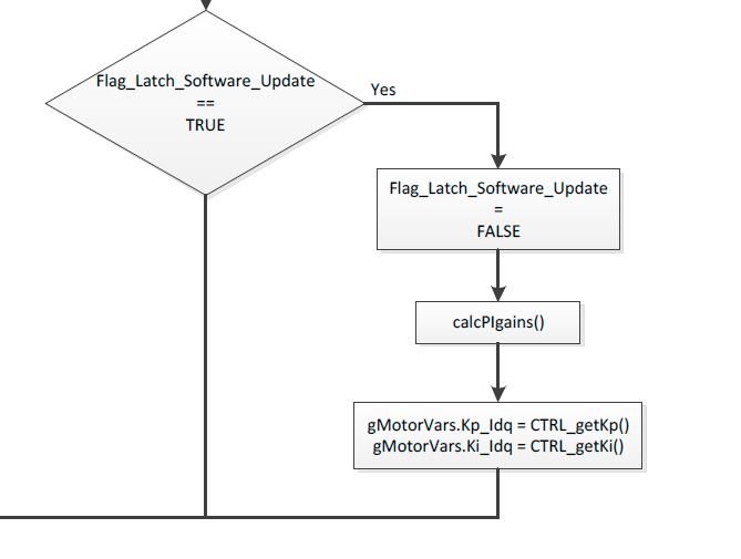

    By lab5b I need in the forever loop to get these parameters while spinning and set them again all the time:
    By this:
    Is this correct ?
    roee
  • USER_calcPIgains shows how the current control gains are calculated and set
    you shouldn't change them unless you have done a step response test and feel that they should be adjusted
    the speed control gains are NOT calculated for you. a starting Kp and Ki are chosen simply based off the USER_MOTOR_MAX_CURRENT setting. You should do step response testing and tune these values to meet your application requirements.

  • OK
    I see also that if I am changing my _IQ change my RPM changes according
    Seems like number of Poles incorrect?
    I have 6 poles in my Motor
    I have chosen:
    #define USER_MOTOR_NUM_POLE_PAIRS (3)
    Since these are PAIR
    Is this correct?
    Or I should put 6 ?
    Roee
  • 6 poles is 3 pairs
    _IQ(0.5) will set a speed of 0.5 KRPM = 500 RPM
    it is actually setting a frequency of 500 RPM * USER_MOTOR_NUM_POLE_PAIRS / 60 = 25 Hz
    everything inside the algorithm is in electrical Hz. The RPM is just created from # of pole pairs to give you an RPM.
    If you think it is low it could be you have # of poles incorrect, not enough voltage on the bus, or incorrect motor parameters
