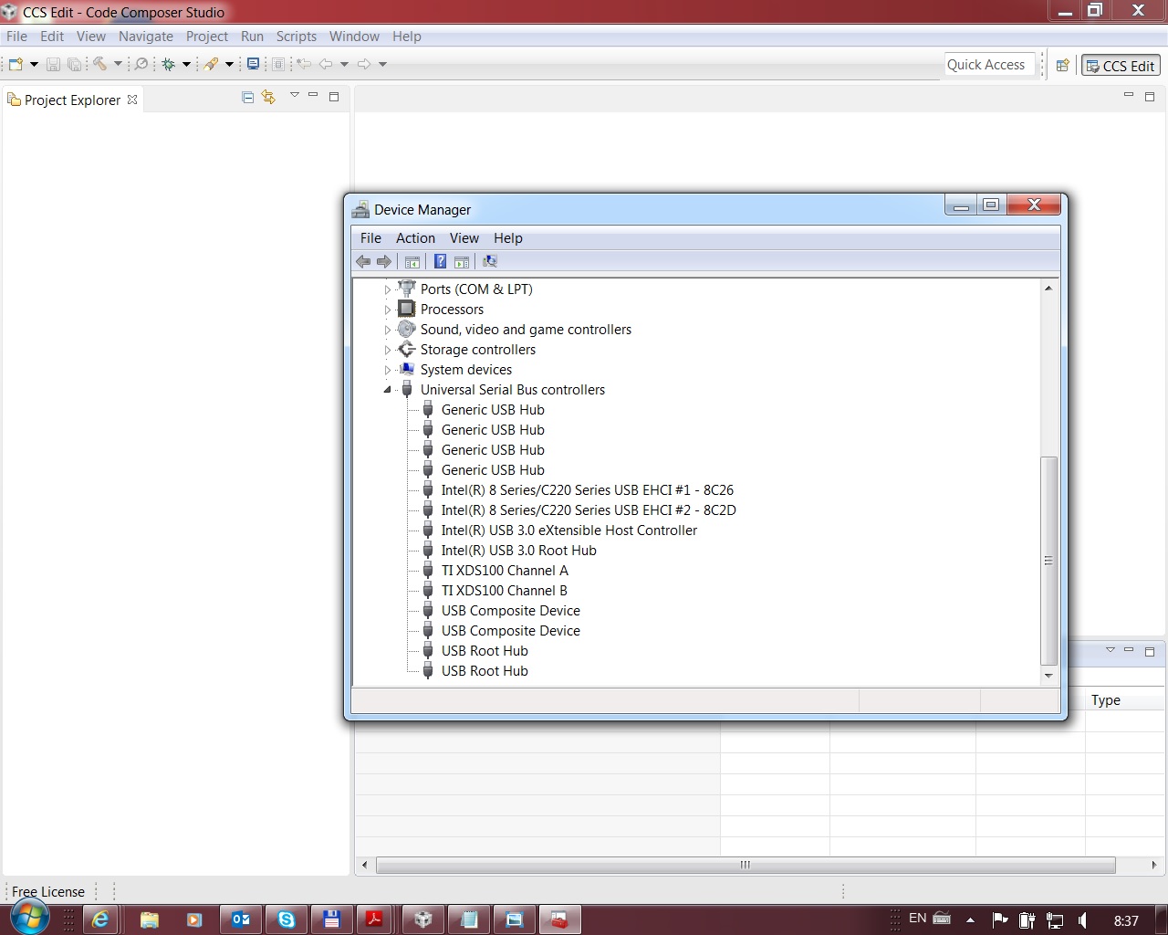

I have been trying to solve following problem. I have installed CCS v6.2.0 under Windows 7
and I have bought emulator XDS100v2. Now I would like to establish connection between
CCS and TMS320F2808 DSP on my control board. I followed the instructions mentioned
in XDS100v2 Quick Start Guide and I have got following error message:
Error connecting to the target Error -1155 @ 0x0. I have checked drivers installation
and it looks alright. I have also checked voltage on pin 5 on JTAG header connector. I have found that there is 3.3 V.
The DSP is also alright in my opinion because some state LEDs on the board which are under software control are
blinking. Can somebody give me some advice where to look for the mistake? Thank you in advance.
    Can you do a 'Test Connection' under Target Configuration window? Paste the results.
    Gautam

  • Great, your XDS looks fine! Something on your controlCard seems to be triggering the 1155 issue.
    Check your JTAG pins status. Also, check this wiki article:
    processors.wiki.ti.com/.../Debugging_JTAG_Connectivity_Problems
    Gautam
  • Thank you Gautam for your advice. Please can you tell me what  state should I expect on JTAG pins? I have found that voltage on
    all pins (pins of header connector on my control board) except nTRST and GND is 3.3 V. Is it right? Thanks.
  • Yes, that is correct !!
