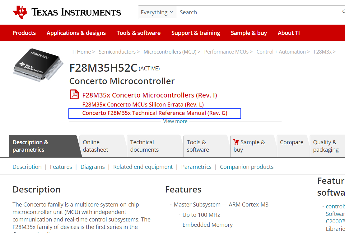

  • Hi MHD,
    The TRM is the device Technical Reference Manual.  You can find it on the landing page for a particular device on ti.com here:
    The first link is the device datasheet, the second is the silicon errata, and the third is the TRM.  You can find additional relevant documents in the "Technical Documents" tab.
    Here is the direct link for F28M35x: http://www.ti.com/lit/ug/spruh22g/spruh22g.pdf
