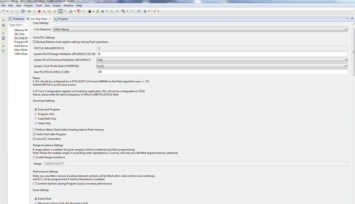

I am trying to connect to CPU2 on TMS320F28377D MCU using TI debugger (XDS100v2). I am able to connect it to CPU1, erase and perform Blank Check. However, if I try to connect to CPU2 by changing the Core Selection to CPU2(slave), then it still is connecting to CPU1 and overwrites my setting as well. Please see attachment.

    In the console it is showing CPU1 only and not CPU2. Please double check the core you have selected. If you are indeed selecting the CPU2 but console is showing  CPU1 then it could be possible that your workspace is corrupted. In that case I would suggest to switch to new workspace and try it again.

  • Avinassh,
    The Core Selection option you are modifying ("CPU1 (Master)" and "CPU2 (Slave)") is an On-Chip Flash option to help the flashing code determine which core it is writing to. But this option does not control which core you are connecting to if debugging a project in CCS.
