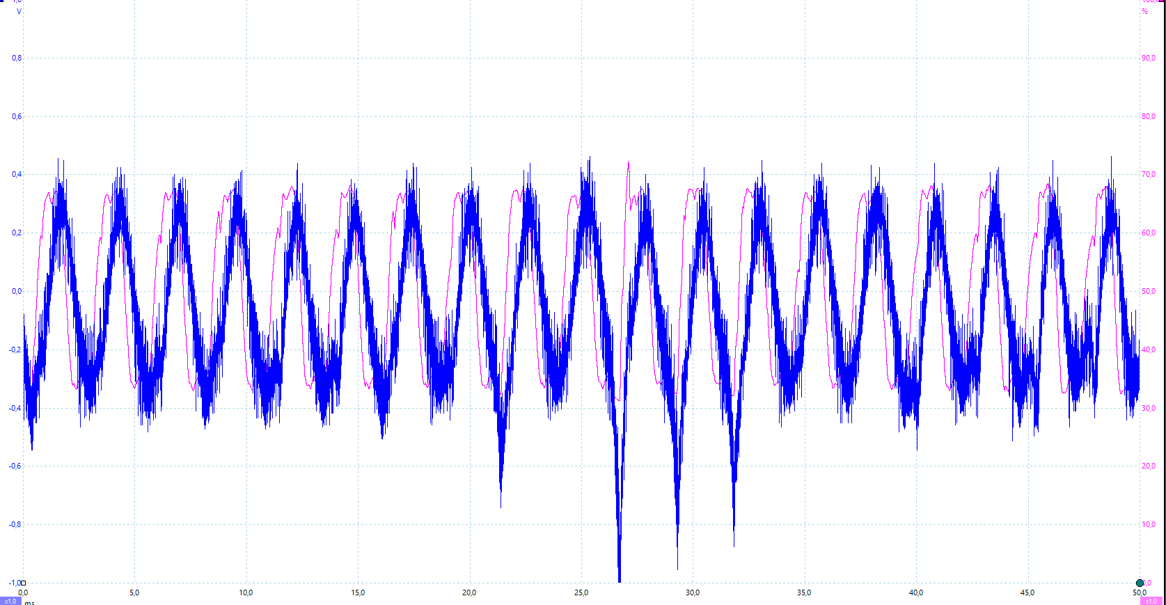

I developed a hardware based on kit DRV8301 RevD using am TMS32028062F (90MHz) prozessor. I have some problems running a motor between 70k RPM and 100k RPM: The current wave form (measured with a current clamp) begins to jump which cause ends in overcurrent after some time. I have two motors from different manufacturer. I have no problem with the weaker one. Maybe because I'm able to operate with a lower Id current.
I'm not sure if the motor parameters are correct because most time lab2b failed to detect Ls_d and Ls_q. Any tips to run a proper ACIM motor identification? Furthermore I'm not sure if the voltage measurement is correct at higher speed because the filter is designed for a lower frequency (USER_VOLTAGE_FILTER_POLE_Hz = 335.648). How do I validate the voltage measurement? Or are the PI-Controller bad optimized?

  • causes:
    a) incorrect parameters
    try using proj_lab02c to ID this motor, but we can't ID all ACI motors, especially low inductance high speed ones. post your parameters
    b) poor current samples at higher speeds
    this is caused by the DRV8301 EVM layout, it has some noise issues
    c) too high of magnetizing current being used, related to a)
    d) poorly tuned controllers
    current gains should be ok, unless Rs and Ls aren't ID'd correctly
    speed gains are not calculated. are you tuning them for stability? if you have stable operation at a lower speed try reducing both Kp and Ki by a factor of 4 and then try high speed again
    the filter pole isn't the issue, though for your own HW I would design this to about 450 Hz

  • Thanks for the fast response. I think I have to figure out the proper motor Id first. But I wasn't successful with lab2c. After locking the rotor the current wave form looks very ugly and the current was very high which cause to motor to heat up. My motor parameters:

  • Changing the motor parameters and reducing IdRated made the high speed operation much more stable.
    Now I have to face another problem: To test the controller I start and stop the motor automatically every 20 seconds. After some starts (between 50 and 100) the current wave form becomes ugly (less sinus like) including negative peaks. This cause over current sometimes. The next start shows a good wafeform again. Any ideas?
  • There is some issue on OVM region with ACIM motor in Motorware 16 and before version, especially the OVM region that just one shunt feed is measured. This issue will resolved on new MW17. So I think you would prefer to use the next MW17 version for your system.
    For workaround, this issue can be a little mitigated if you reduce current PI gains about half .
  • I was able to fix the problem: I changed the code to trigger mainISR by a timer. After every stop I disabled the timer. Now I never disable the timer and the problem has gone.
    Changing the calculated PI parameters haven't improved the result. At the moment I'm able to run up to 92k RPM. Maybe the updates of MW17 help me to reach 100k RPM.
