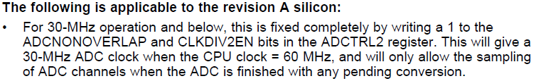

F2806x ADC initial conversion errata
Is it possible that the following workaround to this issue in the F2803x Errata will also work for the F2806x device?
Stuart
  • Hi Stuart,
    Using the /2 bit in the '03x family results in no error because the ADCCLK ends up being 30MHz (or less if the SYSCLK < 60MHz).  The '06x family uses the /2 by default to get an ADCCLK of 45MHz.  In this case, the error is limited to about 4 LSBs, per the '06x errata.  The ADC architecture is virtually identical between these devices, so if you run an '06x device at 30MHz or less I think you should get no measurable error.  I am pretty sure there is a /4 enable on the '06x devices, so you could run at 22.5MHz and presumably have no error. (Note that all of this assumes you have enabled the non-overlap mode.)

    My understanding is that the ADC is running through it's 13 ADCCLK cycle conversion sequence even when the ADC is "idle". When a trigger comes in, and after the voltage is sampled, the ADC immediately transitions to its initial state and goes through the 13 cycles of the conversion. Depending on where it was in its free-running 13 cycle loop, transitioning back to the start can introduce some error. Slowing down the clock gives this error more time to settle out in the first state so it isn't seen in the conversion. The non-overlap setting also alters the conversion process such that the error has more time to settle out. If your triggers are coming at time durations equal to some multiple of 13 ADCCLK cycles, you will either always see the issue or always not see the issue. If the triggers come in at some other frequency (this is usually the case) then the error shows up pseudo-randomly, in about 1 out of 13 conversions. There is a process variation to the magnitude, so most devices won't see any issue at 45MHz. For devices that do see the issue, when it occurs I believe the error will always be in the same direction (e.g. always positive).
    Based on the above, averaging could help, but may not completely eliminate the error.
    Yes, masking the bottom 3 bits would completely mask the error. I am pretty sure you would be better off just leaving the result as-is though, as masking guarantees quantization error, but the first sample issue is usually nothing and at worst 4 LSBs.
