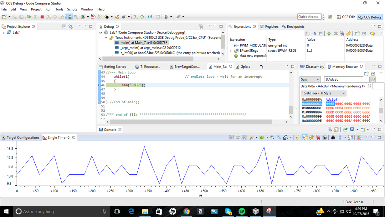

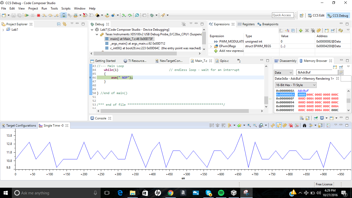

Yes, you should be able to use the F2837xD lab code from my workhop on the F28377S LaunchPad, except for the IPC lab which requires a dual-core device. As a matter of fact, I used a modified version of lab 7 for the F28377S LaunchPad video. You will need to modify the code to use an available PWM that is pinned out on the device. I used ePWM3, and you will need to change the connection to the LED in GPIO.c to GPIO12, as well as modify the code in the ADC ISR to use GPIO12.
The message you received is not an error. The address 0x3fe2ed is located in the Boot ROM and it is assembly code, therefore no "C" source is available.
Just for reference, the new F28379D LaunchPad should work without any code modifications since everything required for the lab is pinned out.
