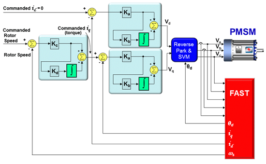

    Also in BLDC motor for FOC control we use 3 PI compensators for velocity, current Iq & Id. See below image :--
    e2e.ti.com/.../8623.Picture1.gif

    Also do both the Iq & Id PI-controller will have effect on the overall openloop transfer function of the system ?
    Or only the Iq Pi-controller which is cascaded with the output of the Velocity PI-controller will have effect on the overall openloop transfer function of the system ?
    Also In below figure i have pointed the modules in RED arrow, which will have effect on overall open loop transfer function of the system.
    Please correct me on this.

  • Dinesh,
    I am saying that the inner current loop PIs are typically designed such that the motor pole is cancelled by the controller zero. Dave Wilson explains this in part 2 of his blog. He uses Ka & Kb as notation for the proportional and integral gains, but he is just exploiting the fact that the transfer function of an ideal PI controller is a real zero and a pure integrator. This is done separately for both Id and Iq loops and, as far as I know, in motor control is very widespread.
    The outer speed loop controller is dealt with in part 3 of Dave's blog and again, he has used a PI controller.
    You have correctly identified those elements which affect the control loop, however the block diagram is incorrect in that the (FAST) estimator does not provide Id & Iq: those come from the Park transform which needs sampled phase currents as inputs. Assuming commanded speed is also a sampled input your statements at the foot of your last post are correct.
    One final point: in his blog Dave's uses an s-domain model of plant and controller. Most of the descriptions I have seen discretize the plant model and then use the z-domain to compute the controller.
