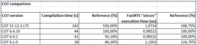

my customer is performing benchmark tests on FastRTS library (in particular function sincos()) on TMS320F28065 device.
The selection of CGT leads to significative compiling time and execution difference!
Tested CGTs: 6.4.10 and 15.12.3.LTS
Same settings: optimization OFF, as in following screenshots:
CGT 6.4.10
CGT 15.12.3.LTS
The execution timing is measured using GPIO set and clear on the following code (within the same source code):

Results
CGT 6.4.10
Compilation time: 44 seconds
Execution time ("sincos" with FastRTS): 0.98522 us
CGT 15.12.3.LTS
Compilation time: 4 minutes and 2 seconds
Execution time ("sincos" with FastRTS): 1.0714 us
This is a 8.75% increase in computational time and a huge increase in compilation time!

  • Vishal,
    while waiting for customer feedbacks on this test, I received this interesting spreadsheet of their differences between various CGT version.
    These are confirming someething wrong is happening.
    I'll keep you posted on their investigations.
