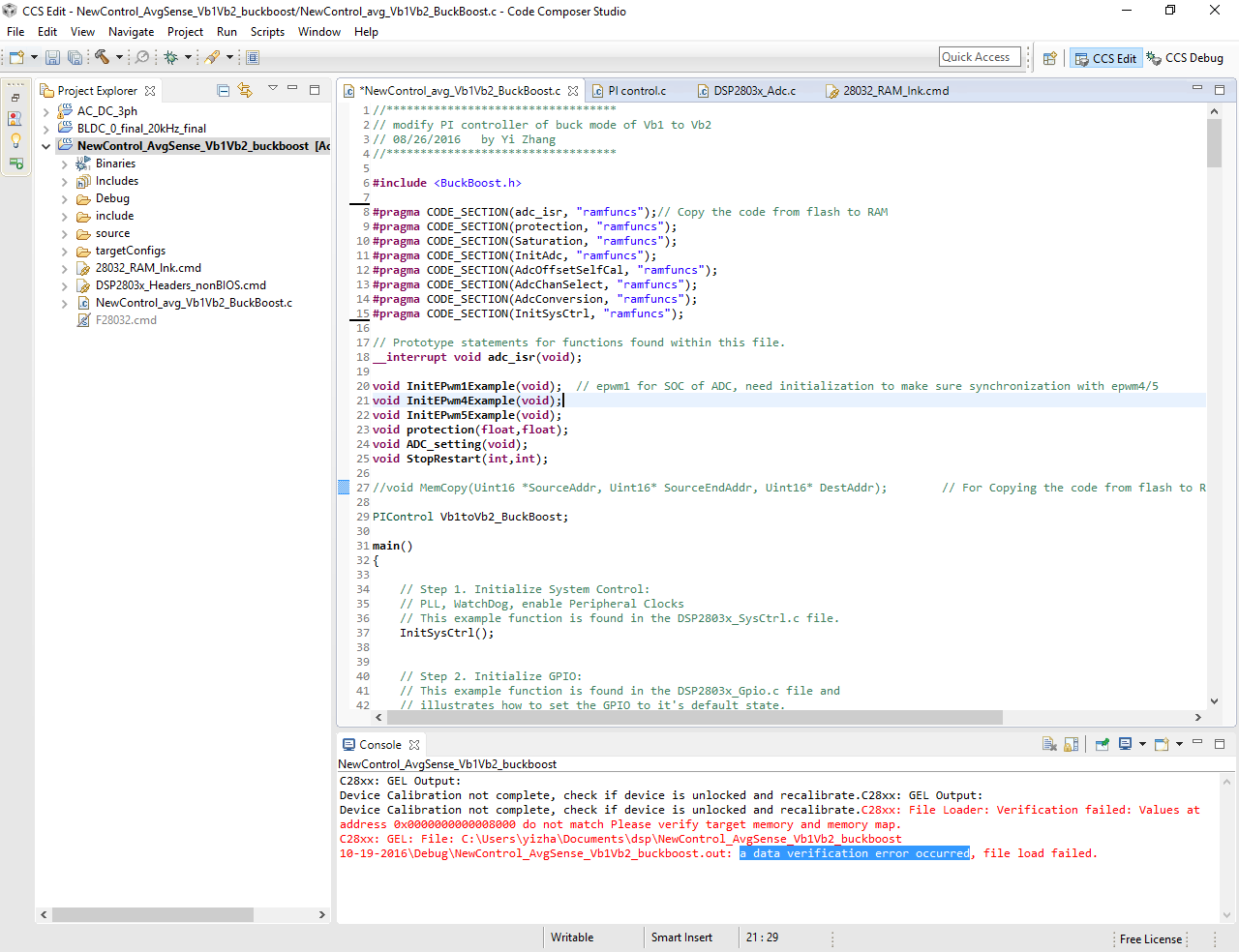

I am using 28069 for current control of buck converter. When I run it in RAM, everything is fine and result is good. Now I want to burn the code into flash. I changed the cmd file and do all ramfuncs settings, while keeping all other codes the same as before. But when I debug the code, there is something with AdcOffsetSelfCal(). I tried to debug it step by step, but when running into this function, it exists automatically. I wonder what is wrong since it is exactly the same code as in RAM. I tried to comment out this function, but it turns out that ADC conversion result will be affected. So I need to keep the function and let the code run as in RAM, can anyone give some hints?

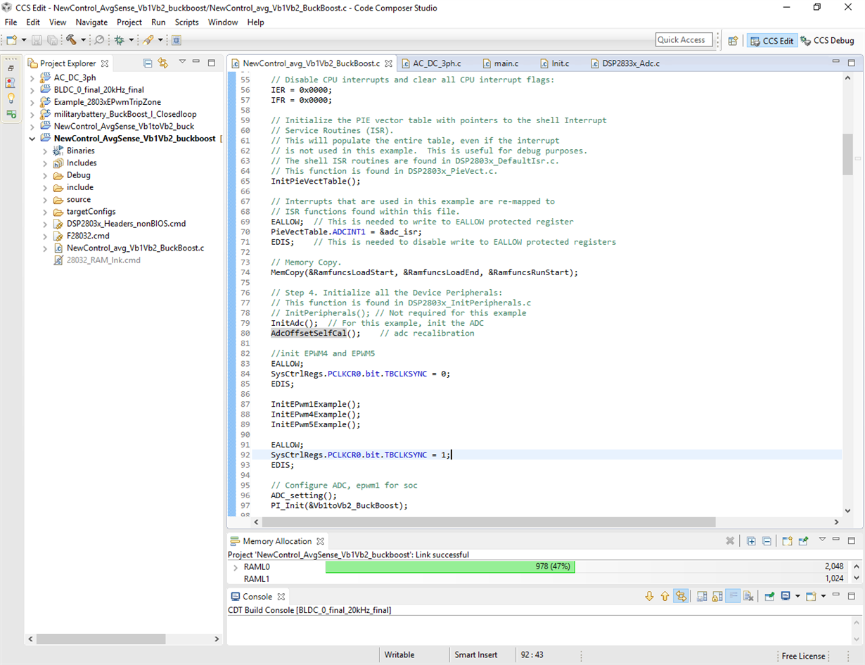

    Thanks for your reply. As you said, this might because of slow CPU when running from flash. But I have copy this section from flash to RAM as shown below, will this still the same? And when you refer to other conversions, do you mean that the offset calibration function is too big and I should write my own, or simply not using calibration except DeviceCal?

    How you do the offset calibration is up to you; it can be done in a variety of ways. We provide an offset self calibration function as an example, but depending on how your application does sampling you may want to do something a little different. The provided function collects data at the maximum possible sample rate, but this is sensitive to having enough CPU bandwidth (so running out of flash may not work). You could do something simpler, like software trigger a single conversion at a time in a loop. This won't be time critical, so you could probably run it directly from flash.
    I do agree that if you burn the example function into flash, but then copy it to RAM, it should work. Have you tried inserting a breakpoint so that you can check if the PC is at a position in flash or RAM while the function is running?
