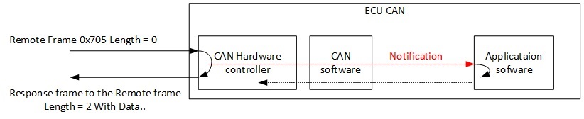

    My ECU has the following scheme:
    It receive a remote frame with length =0 and must respond with a Normal frame containing data:
    The to do this, I have two solution:
    1 - Use an object of type MSG_OBJ_TYPE_RXTX_REMOTE. By this way, the response will be automaticcaly triggered by the Hardware controller when remote frame will received:
    2- Use two objects. First an MSG_OBJ_TYPE_RX_REMOTE to be notified a remote frame is received. Then In the software, send the TX FRAME with an object MSG_OBJ_TYPE_TX:
    This work fine.
    Now, the problem is on CANOpen protocol, the response from the remote contain a field named "Toggle" bit. This means the response data must changed on each response by making a bit toggle. Then, The software must be notified on each received REMOTE frame to change this bit. This is ok by using the second solution exposed above (The notification should be a polling mode or an interrupted mode anyway..):
    But if I want use the hardware capability (first solution exposed above), the software can't be notified to prepare data to send on the next REMOTE frame received:
    Are they a means to know a REMOTE frame was received when configured in Automatic hardware response?
