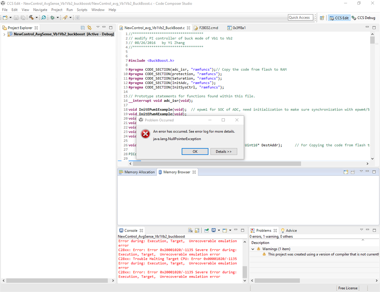

I am  using 28032 flash programming, but when I tried to debug it the error message shows "Device Calibration not complete, check if device is unlocked and recalibrate". I cannot enter debug mode and don't know how to figure this out. Since the same board and code run well in another PC before. I have searched online and saw many similar problems, but I have no idea where to find the password location and value, since I did nothing to the password. Can anyone guide me how to check the password and then decide whether this can be unlocked or not?

    Thanks for the reply. But where can I find the memory watch window? Do you mean memory browser? But when I click on it, there is nothing in the window but error message. Can you post a screenshot or detailed instructions on where to find it?
    As for password, I checked it in "on chip flash" setting (continue launching despite load fail) and it was all "FFFF". So I think I did not change anything.
  • Yes, memory browser. Instead of loading the program, just connect to CCS (right click on target and then click on connect). Then you should be able to use the memory browser.

  • Hi Vivek,
    I checked the browser window, where some values were shown as 0 while others were blank. I thought it was locked and gave up trying to fix it. We replaced the dsp with new one on the board, then the board worked well again. Although I did not figure out how it was locked, I will be more careful in the future when using Flash.
