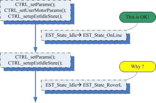

After call CTRL_setParams(), CTRL_setUserMotorParams() and CTRL_setupEstIdleState() function, the estimator state can change from EST_State_Idle to EST_State_OnLine. But then if CTRL_setParams() and CTRL_setupEstIdleState() function are called again, the estimator state will change from EST_State_Idle to EST_State_RoverL. Why ?
Through debugging, the function CTRL_setUserMotorParams( ) should be called again to solve this problem. But I do not know why it is.

  • I just use FAST to control my motor without motor identification based on lab 11/11a, motor can work well, but once system disabled, then try to start up motor again, the estimator state will run into motor identification process, but I do not hope so, I want the estimator runs into online state when restart motor after system re-enabled.
  • Please call below function to enable the use of motor parameters being loaded from user.h, which disable the identification process.
    CTRL_setFlag_enableUserMotorParams(ctrlHandle, true);

  • Ok, did you call below lines code to initialize the estimator using the parameters in user.h without identification when you reset your system.
    CTRL_setParams(ctrlHandle,&gUserParams);
    CTRL_setUserMotorParams(ctrlHandle);
    CTRL_setupEstIdleState(ctrlHandle);

  • Don't need call these functions again if you only stop motor by run flag. Don't know what's your system reset.  Please refer to lab11/11a, or add yourself code based on both projects.
