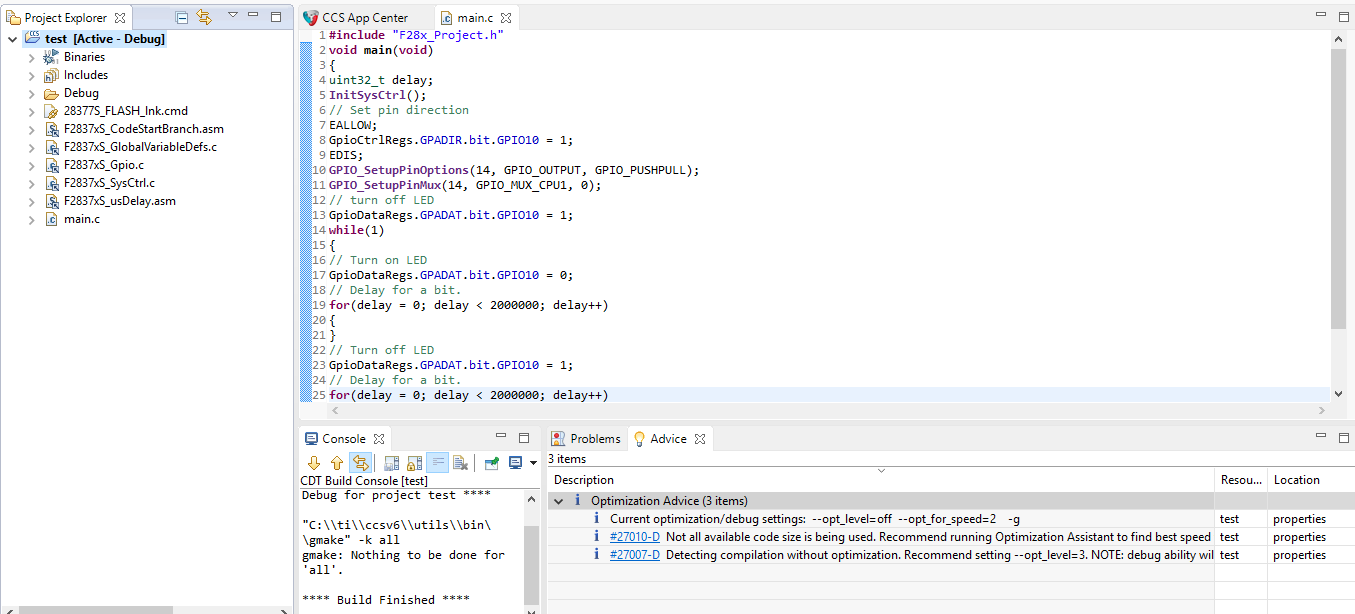

I am using code composer studio version 6.1.3.00034 and I am trying to run epwm_updowm_aq_cpu01 example project from v190 F2837xS_examples of control suite. I am getting errors #10263 and #10264 in both files F2837xS_Headers_nonBIOS,cmd and 2837xS_Generic_RAM_Ink.cmd
I am also getting errors in other example projects and not able to run any code.
Please suggest how to rectify this problem.

  • It seems you've multiple linker files. Can you take a snap of the Project window with attached linker files to it?
  • Because of multiple linker files, I removed include library file 2837x_Generic_RAM_lnk.cmd from Properties/Build/C2000 Linker/File Search Path.
    Also in Properties/Build/C2000 Linker/Advanced Options/Symbol Management, I had to replace program entry point for output module to "_c_int00" from "code_start".
    Then after building the project, I got three optimization advices. Please suggest how to solve this problem. Please find attached the snapshot.
