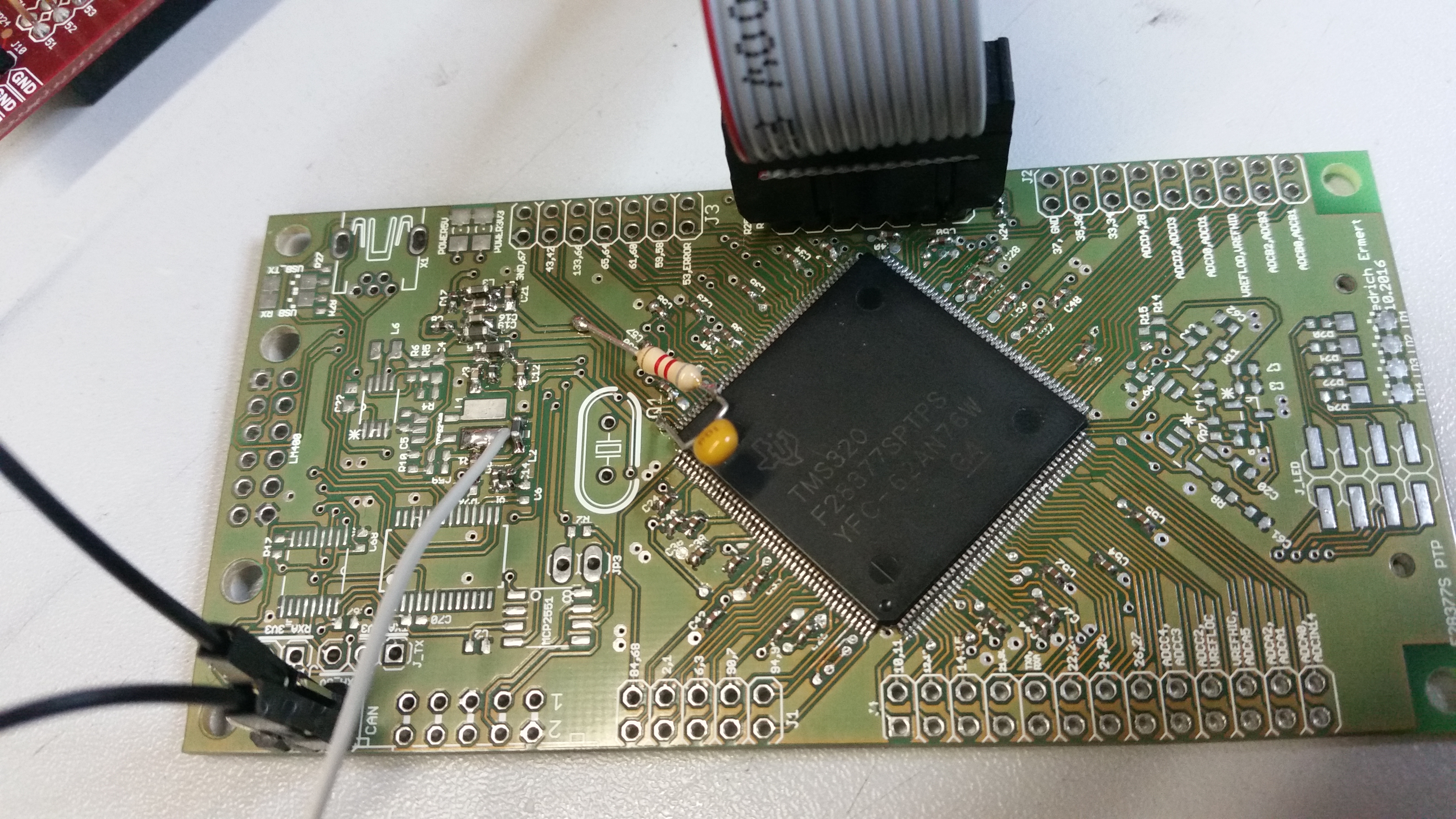

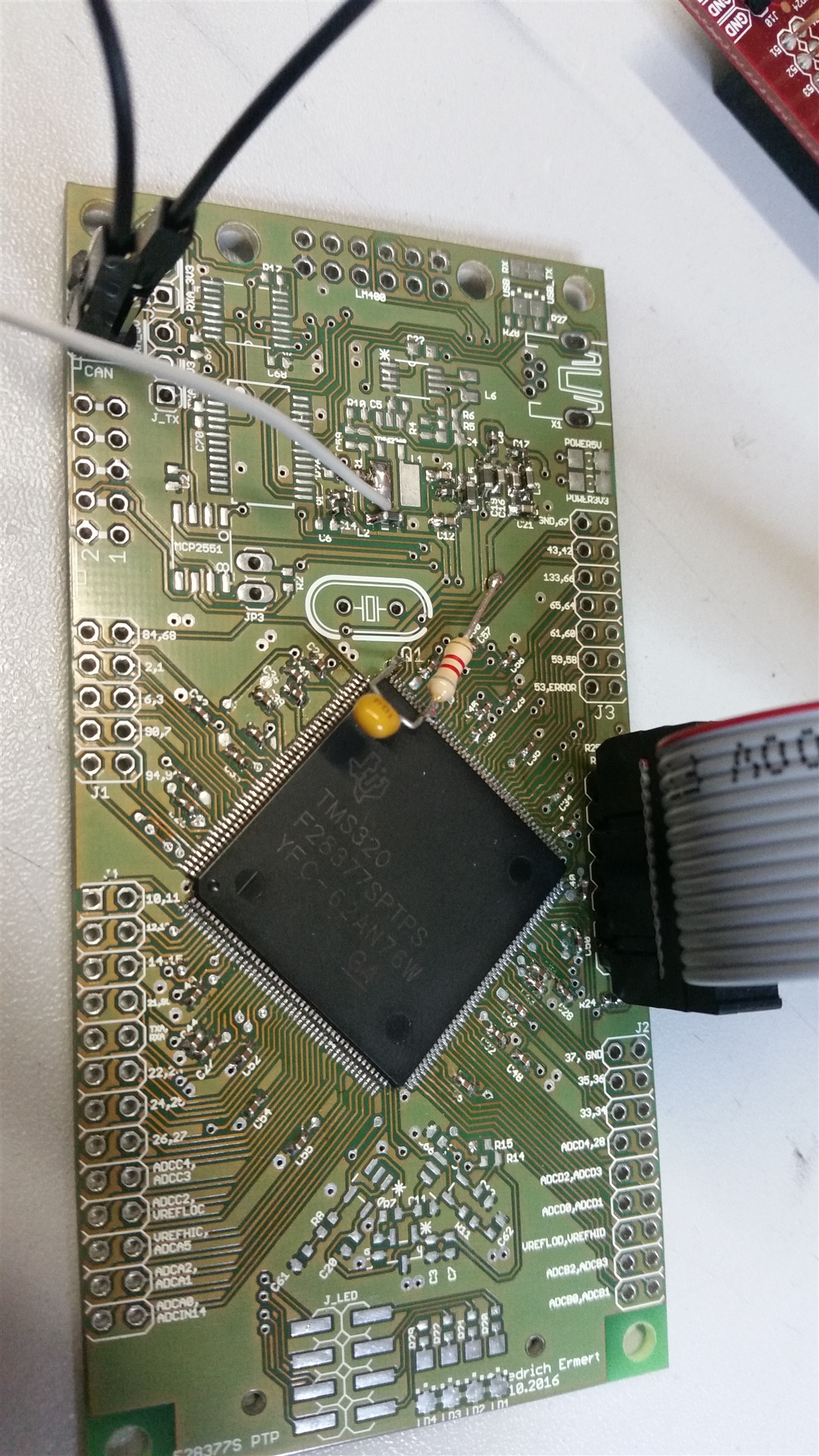

i designed my own PCB with a f28377S PTPT including 256MBit SDRAM on EMIF1.

-check the power supply.
- used onboard JTAG of the TMSF28335 evaluation board (its the one i usually work with, but there is no emif supported)
-used Spectrum Digital XDS100 V2 JTAG
-i measured for short-circuits or connection problems on the PCB

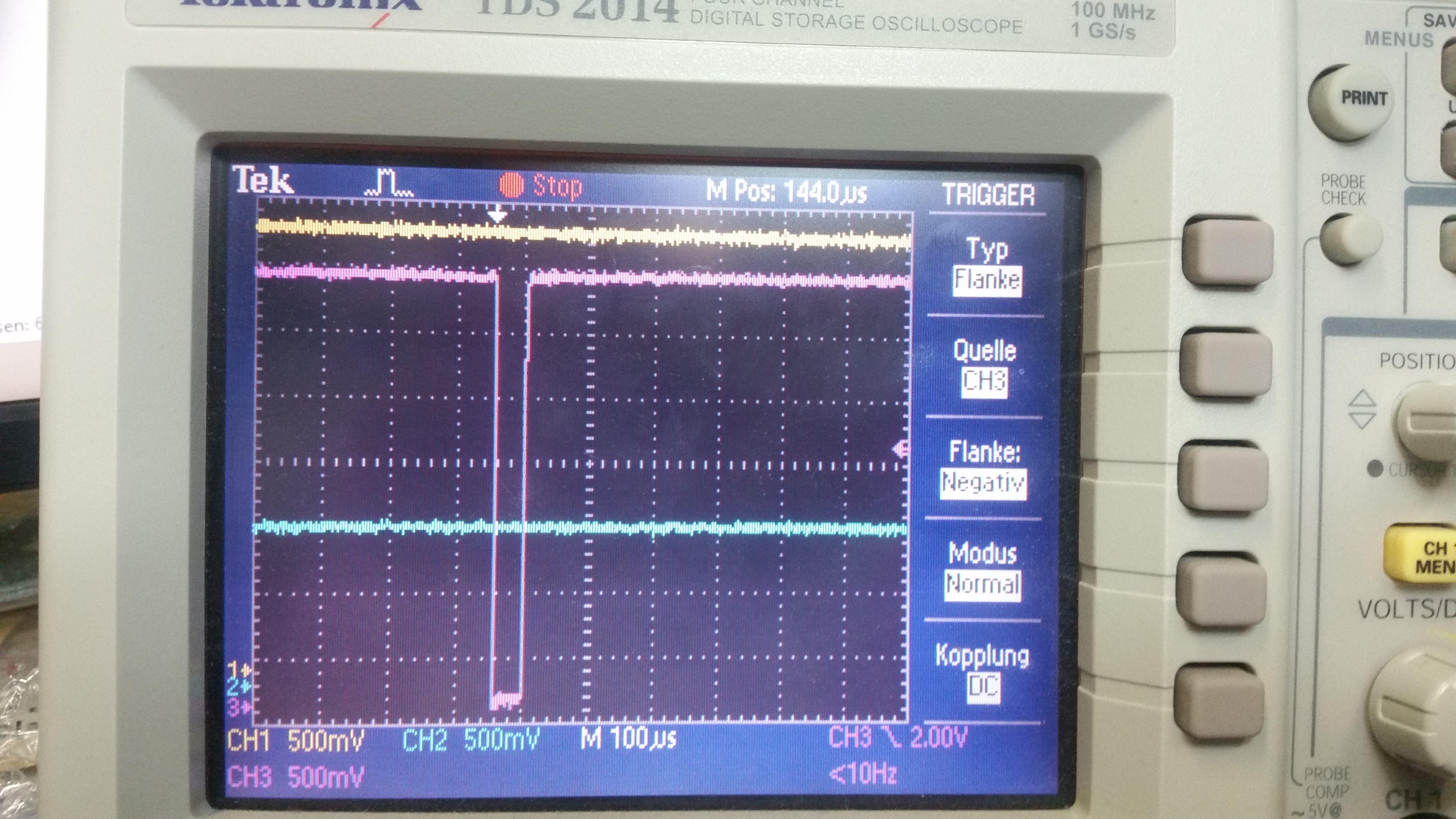

-i tried to have a look at the XCLKOUT  after i configured the pll to a lower frequency with (for example)
GpioCtrlRegs.GPCGMUX1.bit.GPIO73 = 0;
GpioCtrlRegs.GPCMUX1.bit.GPIO73 = 3; // MUS GPIO TO XCLK OUT
GpioCtrlRegs.GPCDIR.bit.GPIO73 = 1;
ClkCfgRegs.CLKSRCCTL3.bit.XCLKOUTSEL = 0; //PUT SYSPLL TO XCLKOUT
ClkCfgRegs.XCLKOUTDIVSEL.bit.XCLKOUTDIV = 2;
But nothing happens on that pin. (?)
-i looked for XRSn Pin, but it's high

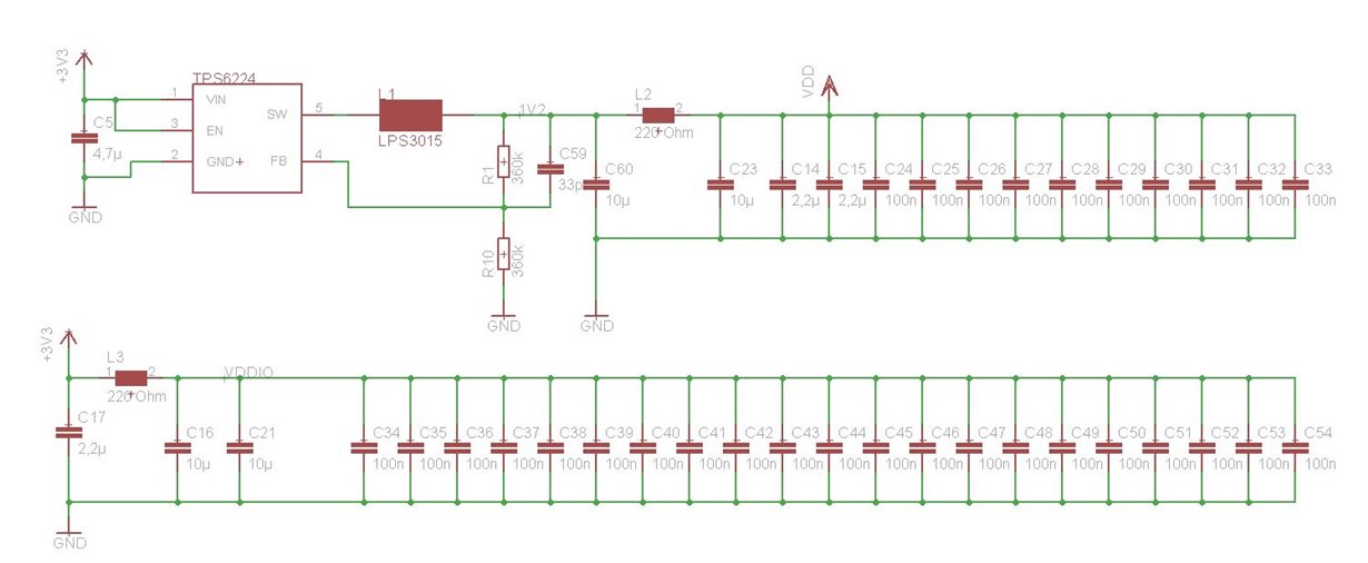

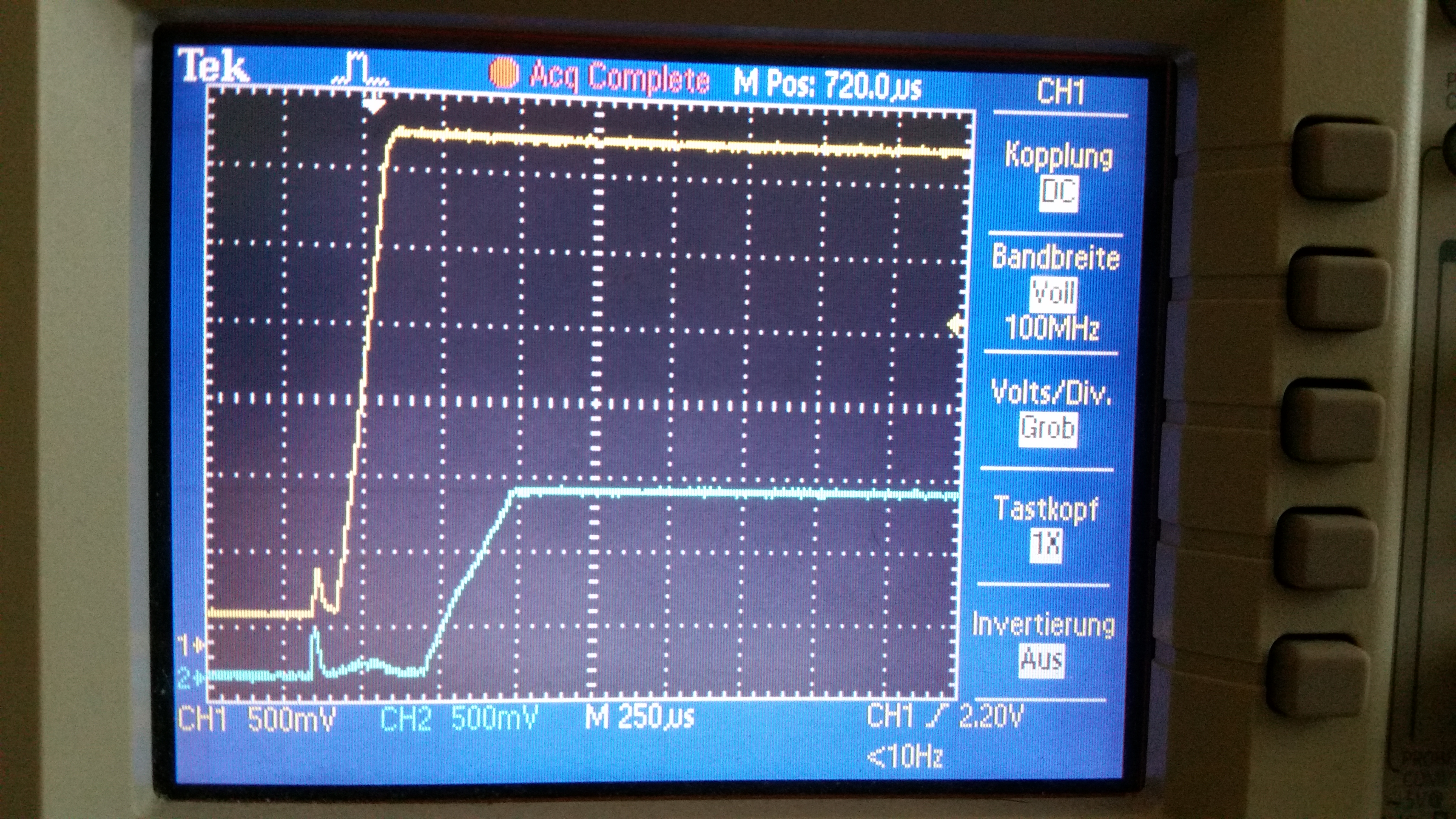

    It seems like supply issue to me. Did you monitor the supply while running the program to see if there is any dip on supply voltage when trying the enable the PLL or peripheral clocks?

  • Hello, thank you very much for your answers at first.
    Yes i already monitored the supplies with a scope, while i enable the PLL and while the error occours. And it looks solid.
    I measured the VVD (1,2V ) and the 3,3V and i cant se any problems.
    Usually i supply the board via USB. I thought maybe 500mA are not enough so i took a 5V, 1A power supply. But no dfference.
    It looks like the supply is not the problem. I also measured all pins of the controller that require a voltage. Its all correct.

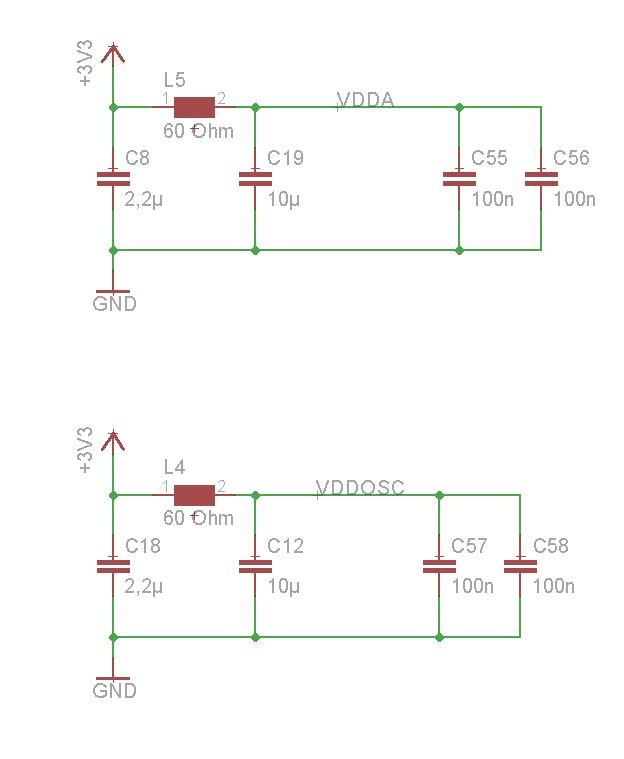

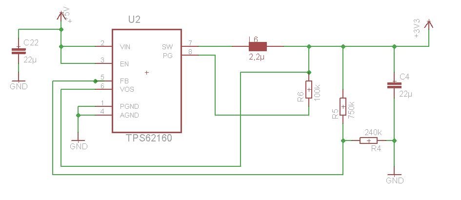

    Is there anything special in the power supply that i have to concider?
    Would it be an advantage, when i load my shematic diagram of the power supply up?

    Did you try using supply with a bit higher current rating (e.g. 3A) to see if that makes any difference?
    I would let Brett comment on other point you have raised about soldering of part.
    Vivek Singh
    no i did not try a supply with higher current rating, because i create the 3,3V by using the TPS62160, that supports just currents up to 1A.

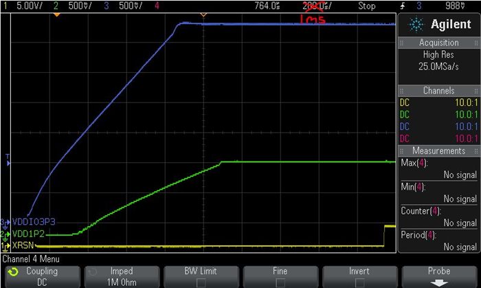

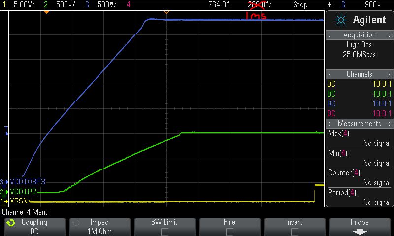

  • Hi Friedrich,
    It would be good to get a scope capture of the power-up waveform in the time scale resolution of 1ms/div with VDDIO, VDD and XRSn from start of VDDIO ramp to ~10ms after. As mentioned by Vivek, it sounds like the device may be current starved when the PLL function is called. Is it possible to capture this and post the waveform here?

    here i captured a frame of 10ms. Yellow is VDDIO, Blue is VDD and violet is XRSn after powerup, without program code in flash.
    I hope i understood you right.
    [URL=http://www.bilder-upload.eu/show.php?file=035e36-1477944858.jpg][IMG]www.bilder-upload.eu/.../URL]
    (I hope the link works)

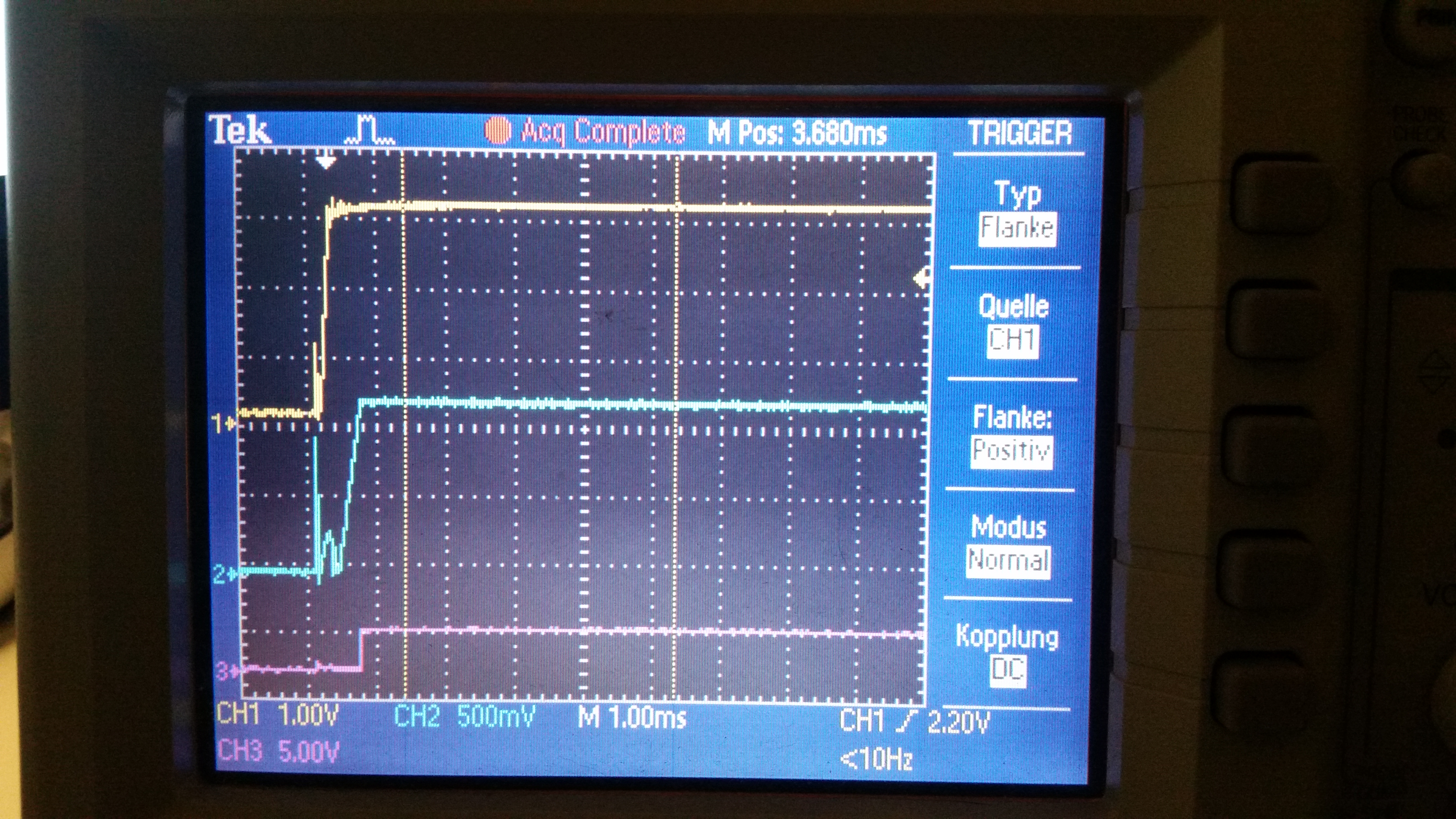

  • Hi Friedrich,
    I am unable to access the host site.  Please attach the image to this thread if possible.
    What I am looking for is with program code in flash and below, but with 1ms/div:
  • Ok here is th capture again ( without code in flash )

  • Due to the voltage peaks at the beginning of powering up i captured a new picture with higher voltage and time resolution:
  • Friedrich,
    Are you no longer able to load code to flash? I would like to see the waveforms when your pattern is loaded to flash.

  • Hi Friedrich,
    OK. Great. To determine if this is a supply or board issue:
    1. Setup the scope to monitor VDDIO, VDD and XRSn
    2. Set the time resolution to 200us
    3. Set the trigger to VDDIO high to low at 2.97V.
    4. Run your pattern
    5. Report the results and send with waveform
    Also, can you please send your schematic or at least the power management section?
    Adam Dunhoft
  • Hi Adam,
    im not sure if unhderstood u right.
    I should watch the falling edge of VDDIO when i started my software on the controller? This is what i did now.
    There is no fallig edge. The voltage drops not under this 2,97V when the error occurs or to any other time. So i have no capture.
    The capture of teh startup did i already post. Should i capture a new one?
    Here is my Powermanagement.
    I can also upload my whole EAGLE Design or more single parts if u want.
    Tanke you and best regards,
    Friedrich
  • Hi Friedrich,
    OK. That is good. Change the trigger of the scope to XRSn high to low transition at 2V and run pattern again. When XRSn goes low, we want to view both rails to see if either rail voltage droops too low.
    Adam Dunhoft
  • Hi Friedrich,
    After looking at your schematic, I am now more convinced of a current sourcing issue. The TPS6224x has a max current output of 300mA. The above experiment should help us determine that is an issue.
    Adam Dunhoft

  • Hi Adam,
    i am getting crazy with this problem.
    So i soldered an completly new PCB, without an own powersupply and any peripherals.
    I only soldered a controler and its capacitors to the board. I supllied the board by an external powersupply with exactly 1.2V and 3.3V. I also soldered the parts to make VDDIO, VDDOSC and VDDA outof the 3,3V.
    The problem is still the same.

  • This is what it looks like at the moment.
    The controler ist new.
    Only the supply voltages are connected to the controller.
    And i am still not able to configure that PLL.....
    (The resistor and capacity go to XRSn pin. There is no short circuit. ) =)
