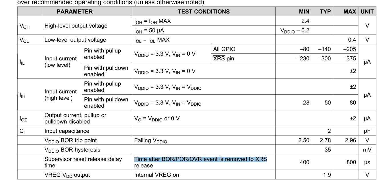

Now my customer meet a question about F28069 reset time, we find in 85°C temp, we use outside reset IC to control F28069 reset pin, we set if VDDIO below 3.1V, will trigger reset and find if reset held time is 400us, sometimes MCU cannot reset successful, we use a toggle GPIO to tracking whether user code run.
If we change held time(held in 0V in XRS) to 900us, it always run normally.

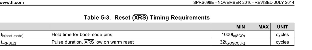

My question is how many time should keep reset low, then can confirm F28069 will run normally? I find datasheet have mention in table5-3, it just 32tc(OSCCLK), but now it seems not work.
Sencond question is in datasheet section5.4, we have a parameter "Supervisor reset release dalay time", test condition is Time after BOR/POR/OVR event is removed to XRS release, so what is the OVR means? Is it means outside reset source held XRS low time?

  • Joe,
    You should be following "Supervisor reset release delay time" and not tw(RSL2).
    tw(RSL2) is the amount of time XRSn is pulled low on WD reset etc. Since you are using an external supervisor circuit, you should be following Supervisor reset release delay time. So, wait for 800us and then release the device from reset for normal operation
    I'm not sure about OVR. I will get back on that soon.
    Manoj

  • Joe,
    Yes, 800us should be good enough at high temp as well. Did you already try 800us at high temp?
    Manoj

  • Joe,
    Minimum time to hold XRSn is 400us.
    Manoj
