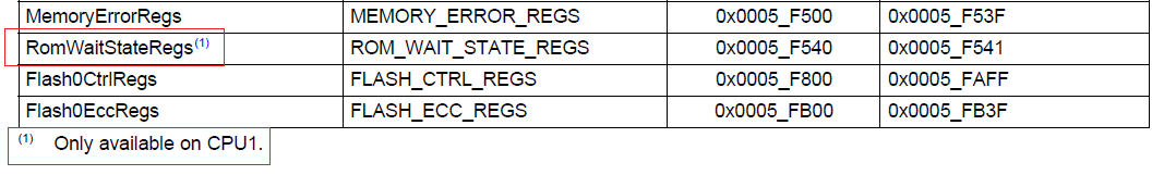

  • Hi Rob,
    Is there anywhere in the documentation where you highlight which register sets are 'system global' or CPU1 only, and which ones need to be set by each processor?
    In register structure  table there is note which mention the register which are accessible by CPU1 only.
    Following snapshot from "Table 2-16. System Control Base Address Table".
