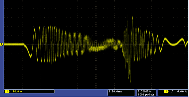

The waveform of Motor current is as follows,
As I set USER_MOTOR_MAX_CURRENT = 20.0, the motor current should be within 20.0A.
But some waveforms were exceeded over 20.0A.

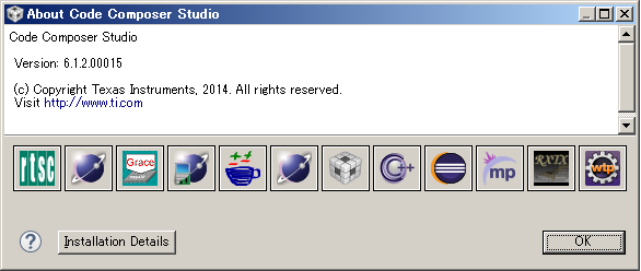

My MotorWare Version is MW16 and my CCS version is 6.1.2.

  • USER_MOTOR_MAX_CURRENT is for the maximum torque current (Iq), not the peak current in your waveform, it is far less than the peak current. You need to set the USER_MOTOR_MAX_CURRENT in user.h based on your motor. Please ensure the motor parameters in user.h is correct, and you can use lab02a to identify the motor parameters if you didn't know them.

    In our motor circuit, a regenerative power consumption circuit was attached,
    but regenerative electric power exceeding that circuit occurred,
    it is thought that overcurrent flowed to the motor, resulting in motor breakage.
    In order to reduce regenerative power, Jerk and motor speed settings of lab10b were changed.
    Jerk did not change much, and changing the speed from 8500 rpm to 7500 rpm, the overcurrent phenomenon disappeared.
    Although the motor speed has decreased, 7500rpm operation is still OK for our application.

  • Did the motor run in field weakening mode? Regenerative circuit is often used for over voltage protection. It's better to use hardware protection to turn off PWM output to avoid motor over peak current.
