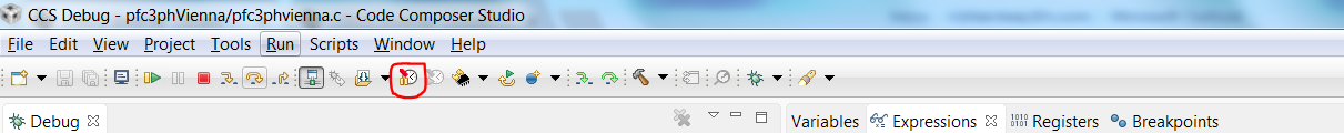

  • Ovie,
    The real time debug button is situated on the top bar, it is a clock sign with a pause icon on top of it,
    The watch window is called the expressions view in the new CCS, View-> Expressions
    Unfortunately the CCS menu icons are inconsistent between revisions :(
