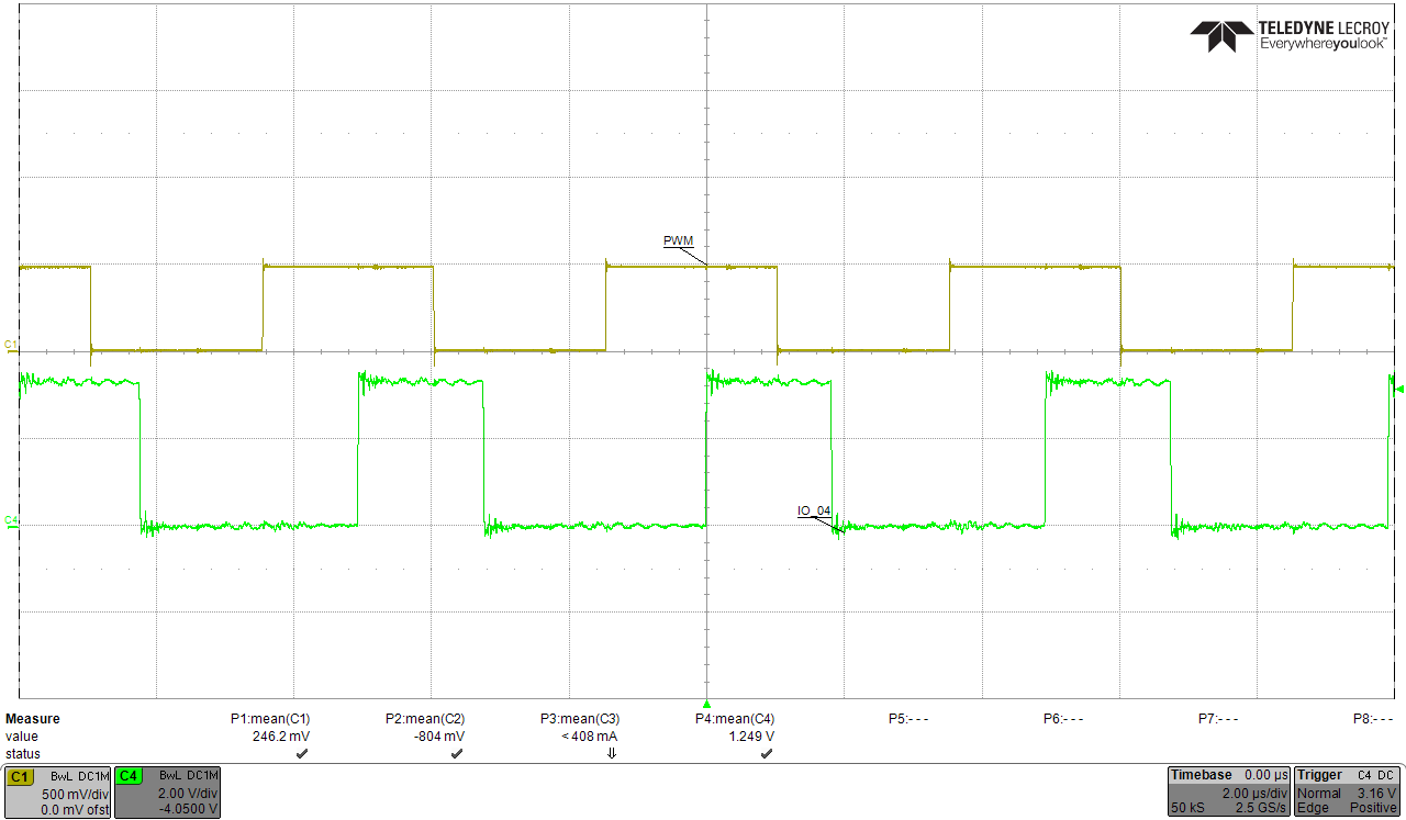

    Now, the reality is that my software must execute 4 adc readings inside the interrupt. So I can do it as follows: (case 1)
    interrupt void epwm6_isr(void) {
    	//	ADC measurements (input, output voltages)
    	IO_04_ON();
    	AdcbRegs.ADCSOCFRC1.bit.SOC4 = 1; // Software forced start of conversion in ADC B4 (input voltage)
    	AdcbResult4 = AdcbResultRegs.ADCRESULT4;
    	vpv_r = (-0.03962) * ((double) (AdcbResult4)) + 74.92; // measurement #1
    	AdcaRegs.ADCSOCFRC1.bit.SOC2 = 1; // Software forced start of conversion in ADC A2 (input current)
    	AdcaResult2 = AdcaResultRegs.ADCRESULT2;
    	ipv_r = (-0.004346) * ((double) (AdcaResult2)) + 8.217; // measurement #2
    	AdcdRegs.ADCSOCFRC1.bit.SOC0 = 1; // Software forced start of conversion in ADC D0 (output voltage)
    	AdcdResult0 = AdcdResultRegs.ADCRESULT0;
    	vo_r = (-0.08432) * ((double) (AdcdResult0)) + 159.5; // measurement #3
    	AdccRegs.ADCSOCFRC1.bit.SOC2 = 1;// Software forced start of conversion in ADC C2 (output current)
    	AdccResult2 = AdccResultRegs.ADCRESULT2;
    	io_r = (-0.01759)*((double)(AdccResult2)) + 33.16; // measurement #4
            IO_04_OFF(); // and the interrupt continues with control code, and ePWM CMPA/B update
    but, if I understood correctly this is not the best way. A better way would be the following, in which I set the flags to make sure that the ADC has finished the conversion: (case 2)

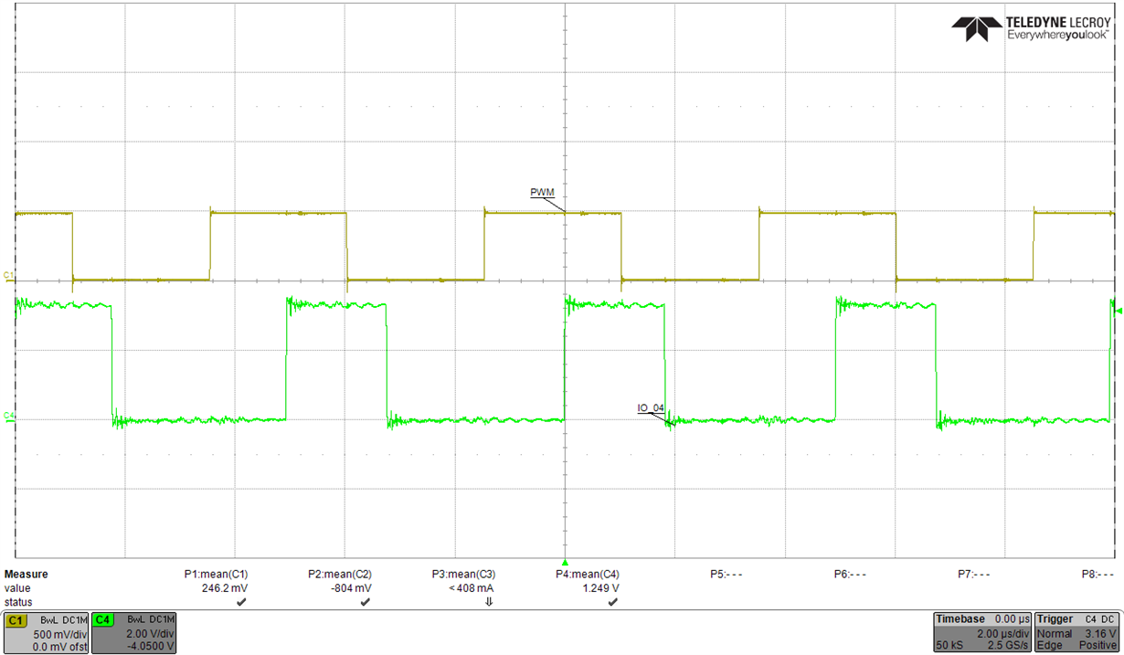

    In these two examples I am using IO_04() to monitor how long the "measurement" part inside the interrupt lasts. The pictures below show the example of case 1
    and case 2 (software triggered conversion with flags set up correctly) is below:
    the adc conversion takes much more time in the case 2 where I set up the flags advising when the ADC conversion is finished. However this seems to be the correct way. I am just concerned that, since the ADC takes ~2us out of my 5us switching period, I will not have enough time left to run the control action and update the PWM value inside the pwm interrupt, if I want to execute all this calculations (measurements + control + CMP value update) inside 1 switching cycle.
    In case 2 though, I am using 4 ADC modules sequentially, without taking advantage of the fact that the the conversions can be run in parallel since I am using 4 separate ADC modules. Hence the long time taken to convert my measured values.

    	IO_04_ON();
    	AdcbResult0 = AdcbResultRegs.ADCRESULT0;
    	AdcaResult0 = AdcaResultRegs.ADCRESULT0;
    	AdccResult0 = AdccResultRegs.ADCRESULT0;
    	vpv_r = (-0.03962) * ((double) (AdcbResult0)) + 74.92;
    	ipv_r = (-0.004346) * ((double) (AdcaResult0)) + 8.217;
    	io_r = (-0.01564)*((double)(AdccResult0)) + 29.42;
           IO_04_OFF(); // and the interrupt continues by calculating the controls, and updating the CMP values for the PWM...
