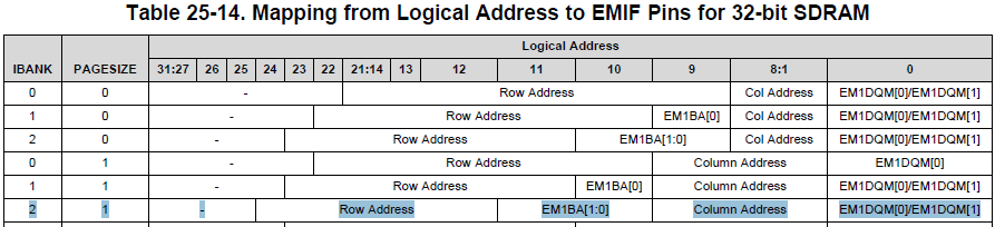

    I do have additional questions regarding configuration of SDRAM mode interface:
    I have a 32 bit wide SDRAM IS42S32800J-7BLI  (attached)IS42S32800J-7BLI.pdf
    With two CS, 9 column address pins and 12 row address pins and 4 Byte mask bits.
    My questions relate to SDRAM_CR
    “14 NM R/W 0h Narrow mode.
    Set to 1 when system bus width to memory bus width is 2:1 for SDR SDRAM.
    Set to 0 when system bus width to memory bus width is 1:1 for SDR SDRAM.”
    Since the bus width and the memory device have the same width, that would suggest setting it to ‘0’.
    But how does it know my device size and the desired configuration width of the bus (both 32 bit wide)?
    “6-4 IBANK R/W 2h Defines number of banks inside connected SDRAM devices:
    000: 1 bank SDRAM devices.
    001: 2 bank SDRAM devices.
    010: 3 bank SDRAM devices.”  = = = = I believe this is actually 4 banks. ??
    2-0 PAGESIGE R/W 0h Defines the internal page size of connected SDRAM devices:
    000: 256-word pages requiring 8 column address bits.
    001: 512-word pages requiring 9 column address bits.
    010: 1024-word pages requiring 10 column address bits.
    011: 2048-word pages requiring 11 column address bits.
    = = = I believe what is actually being controlled for here is the number of column address bits.
    “Using the settings of the IBANK and PAGESIZE fields of the SDRAM configuration register (SDRAM_CR), the EMIF determines which bits of the logical address will be mapped to the SDRAM row, column, and bank addresses.”
    I am not clear there is enough information given to allow the Delfino to configure for my 32 bit wide SDRAM.
    Where do I configure the EMIF1 to be 32 bit wide?
    System bus is 32bit and it's internal setting of EMIF which is taken care in hardware. Based on this configuration, EMIF IP understands the external device configuration (16bit or 32bit).
    You are right. This should be 4 bank. We will correct this in next release. Thank you for this info.
    That is correct.
    As mentioned in Ist point, once you configured NM field to '0', EMIF IP understands that external device is 32bit wide.
    Vivek Singh
