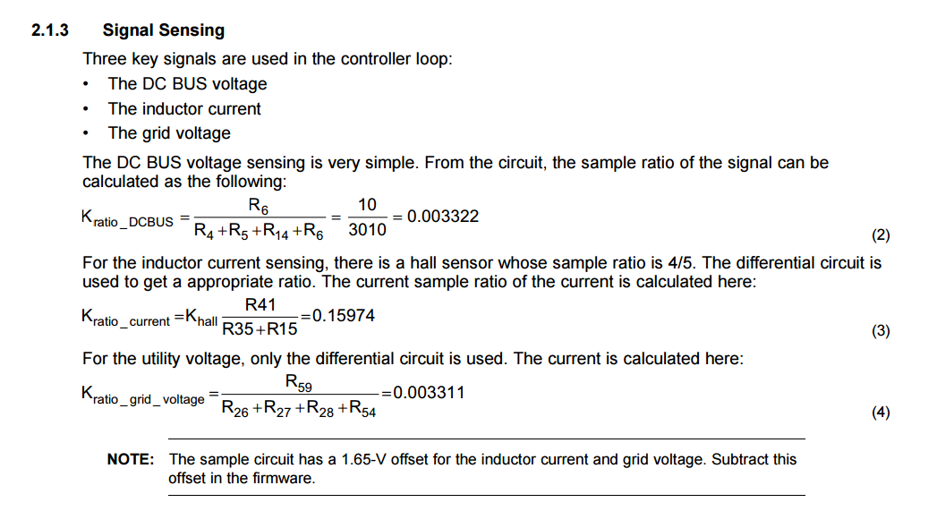

My Question : I want to change K parameters , of DC bus voltage, inductor current and AC voltage. so that system will see DC bus as high voltage when I connect low voltage.
I looked at the firmware files, but I could not find the K parameters . But in technical document they have mentioned such a parameters.( Page 6.  2.1.3 )
Anyone please tell me how to change those parameters and cheat the firmware ?
