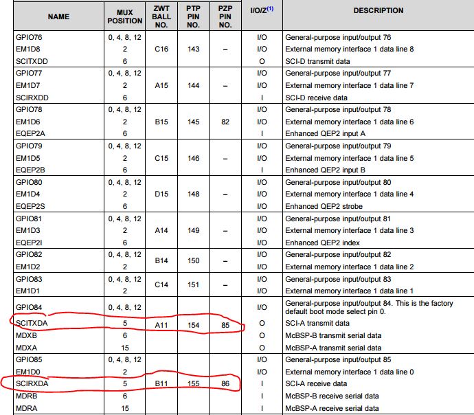

    Which looks correct:
    PZP Pin 86 = GPIO 85 = SCIRXDA
    PZP Pin 85 = GPIO 84 = SCITXDA

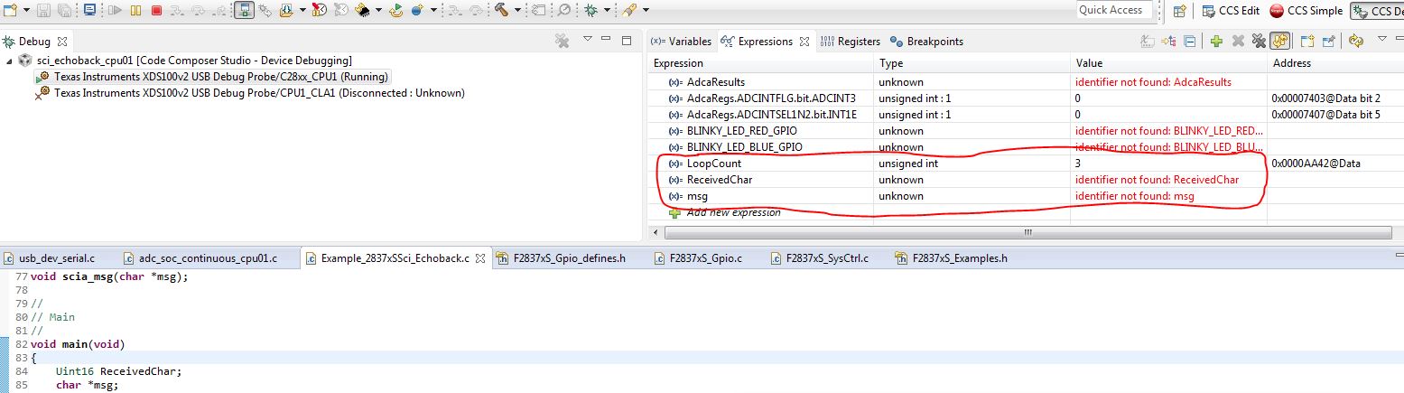

    I added ReceivedChar but I never seem to get anything. In fact, CCS shows the following:

  • Hi Cody,
    After digging around with the register tables and adding SciaRegs to my Expression list, I discovered that all of the data/code does seem to be working properly. When I press a key in my terminal, I see that value appear in SCIRXBUF.SAR as expected, and the character even gets placed into the SCITXBUF to be sent out.
    However, as I previously mentioned, I am never receiving anything on the transmit pin. I now believe that there is a problem with the way my transmit and receive pins are set up. Here they are again
       GPIO_SetupPinMux(85, GPIO_MUX_CPU1, 5);
       GPIO_SetupPinOptions(85, GPIO_OUTPUT, GPIO_ASYNC);
       GPIO_SetupPinMux(86, GPIO_MUX_CPU1, 5);
       GPIO_SetupPinOptions(86, GPIO_INPUT, GPIO_PUSHPULL);
    Now when I look in F287xS_Gpio.c, I notice this snippet in the comments, stating that an OUTPUT can never be ASYNC, only the input can.

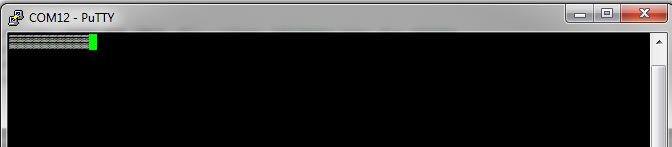

    Making these changes, I am now seeing garbage on my terminal output at the specified 9600 baud in the code. Getting closer now, and the only thing I can think of now is something funny going on with the baud rates and the SCIHBAUD and SCILBAUD.
    This is what I'm seeing on the terminal output, no matter what characters are passed from being hard-coded or pressed on the keyboard:
  • My mistake for recommending the wrong GPIO setup, it goes to show how easy it is to gloss over the code and miss small details. I am glad you solved that!
    For the second issue make sure that the following formula is used "SCI Baud = LSPCLK / ((BRR + 1) *8)" to calculate the baud rate. More details about this are in section 18.14.2.3 of the Technical Reference Manual.
