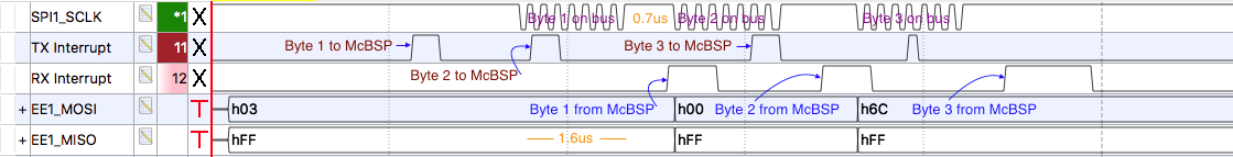

With a TMS320F28335 McBSP port configured as a SPI master with transmit and receive interrupts enabled, occasionally a receive interrupt is missing. That is, one fewer receive interrupt is generated than the number of bytes sent. The IFR and PIEIFR registers show that no interrupt is pending, and the McBSP SPCR1 register shows that RRDY is 0. There are no transmit or receive sync errors or receive overflows.
Transmit and receive interrupts are enabled when the system has bytes to send. The transmit ISR disables the transmit interrupt when the required number of bytes have been sent; the receive ISR disables the receive interrupt when the same number of bytes have been received. Sometimes thousands of bytes can be received before missing one, sometimes just a few. The problem seems to be made worse by enabling other interrupts, such as the timer and SCI, and occurs more frequently the faster the clock (greater than 2 MHz).

  • Hello Colin,
    If you disable all other interrupts, do you still lose data? Can you confirm on an oscilloscope if you are transmitting all of your data? Can you enable internal loopback and see if the issue still persists?
    What happens when your asserts fail? It may be possible that you get the interrupt and then somehow the other code in the ISR causes the byte to be ignored. A way to test this might be to just add a simple TX and RX counter in each ISR. When you appear to lose data, you can check to see if the ISR fired.

  • Mark,
    Thank you for your reply. At this point, I'm looking for any other ideas that I haven't tried. If I disable all other interrupts, I do not appear to lose data. I have confirmed on an oscilloscope that data is clocked out and the problem is still the same even with internal loopback.
    Also, running out of flash memory or out of RAM does not make a difference.
    None of the asserts fail - I put them all in there to check my assumptions about the state of the various registers and none of them trigger. The interrupt flags are on when they are supposed to be, the XRDY and RRDY flags are correct, and none of the error conditions (RFULL or RSYNCERR) are indicated. I simplified the transmit and receive ISRs a bit when I included them here - I do keep metrics on all of the interrupts (rx and tx interrupt counts, bytes received and transmitted) and can confirm that one fewer receive interrupts is generated than transmit interrupts. So the metrics end up looking like:
    • tx_bytes: 360
    • rx_bytes: 359
    • tx_interrupts: 360
    • rx_interrupts: 359
    If it were just a problem with interrupts, then I would expect IFR to not indicate that an interrupt was pending, but that RRDY would still be set to indicate that I hadn't yet pulled the most received data out of DDR1. But neither IFR nor PIEIFR indicate that a receive interrupt is pending, and RRDY is cleared so there is no data to get from DDR1.
    Even when it looks like everything is working fine, I can cause the problem to occur by using the debugger. Based on the pipeline for transmit bytes (XDR1 -> XSR1 -> MDX1) and receive bytes (RSR1 -> RBR1 -> DDR1), I get two transmit interrupts before I get the first receive interrupt. The first second transmit interrupt occurs when the first byte is being clocked out, and the first receive interrupt occurs around the time the second byte is being clocked out.
    If I suspend the execution while the receive interrupts are two behind the transmit interrupts, I miss one receive interrupt after resuming execution. If the receive interrupts are only one behind, or I have received the same number as I have transmitted, I can resume execution without a problem. If it only happened during debugging, I wouldn't care (so much), but I appear to run into the same problem during normal operation.

  • Mark,
    If the debugger is connected, the problem still occurs. It also still occurs in Soft Stop mode - pausing the execution while the receive is two bytes behind the transmit still causes a missed receive interrupt.
    Putting a 1 ms delay between transmit blocks does not change the behavior. The test that I am running now sends three bytes at a time, using the transmit interrupts to pull each byte out of a buffer. The buffer is re-sent by the main loop when a flag is set after the final byte is received. When the third byte of the trio isn't received, the main loop just spins waiting for an event that won't ever come.
    However, if I put a 2 usec delay within the transmit ISR, everything appears to behave as expected. A 1 usec delay does not change the behavior, but a 2 usec delay does. Does this point to anything useful? (Although I was still able to trip it up by suspending execution at just the right time, even with the 2 usec delay.)
