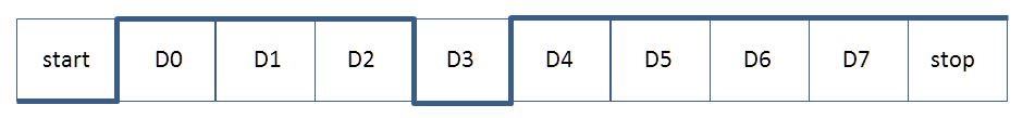

    I cannot explain why the customers test case is sync'ing.  Here is a counter example.  Suppose the transmitter was continuously transmitting 0xEF:
    Now suppose the receiver was hot-plugged such that it started monitoring the RX line at the D1 bit.  It would see the D3 bit as a start bit, and D2 as the stop bit.  In other words, it would see:
    D3 = start
    [D4, D5, D6, D7, stop, start, D0, D1] = data bits
    D2 = stop
    and it would think it was receiving 0xFB.
    There is no way for the receiver to know the data is wrong.  In this example, start and stop bits would continue to re-occur in the correct locations (D3=start, D2=stop, with data bits in the middle).
    What you need to do is insert some idle time, at some point, so the receiver can get sync'd up.
