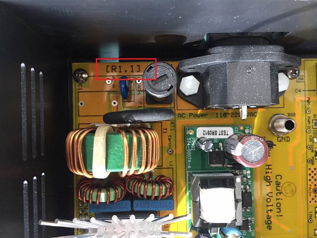

  • Jose,
    When you received your board, was the PCB green as shown in the picture of this document? www.ti.com/.../sprugu7.pdf
    Or was the PCB yellow?
    Sean
  • Jose,
    As Sean mentioned, please check the version of your hardware board, I feel maybe the guide document you are reading is not corresponding your hardware board.

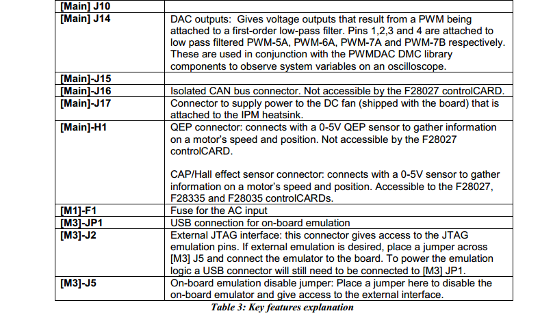

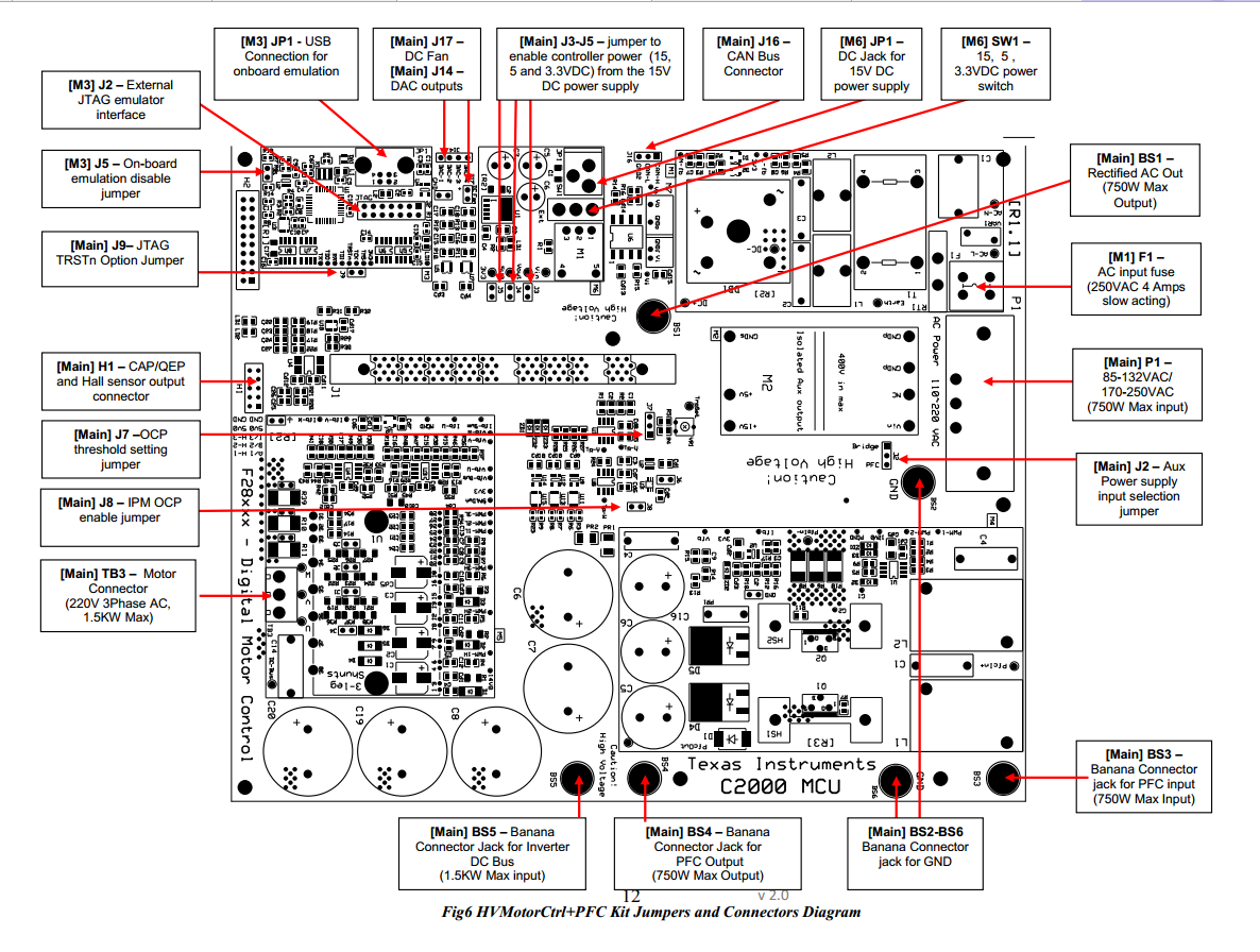

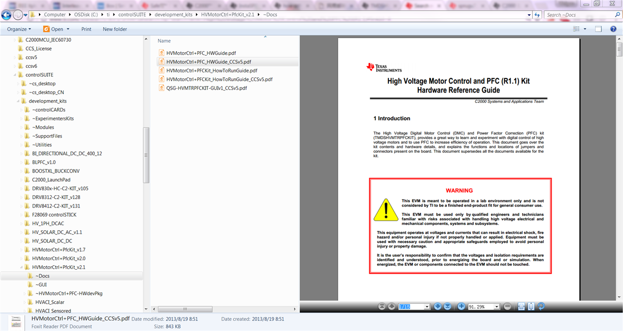

    And the corresponding guide document could be found in controlSUITE folders shown as below
    Choose the document of "HVMotorCtrl+PFC_HWGuide_CCSv5.pdf“
    on Page 12 you will see
    and on page 13 all the jumpers explanation is listed.
    Hoping this will help you.
