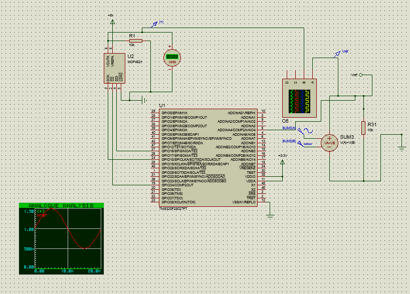

Hi;
I am new with PICOLLO and Embedded coding.  I am using TMS320F28027PT, using CH4(AIO4) to read an analog input and I need to use a 12 bit DAC MCP4921 that
should output the analog signal read by ADC.
I am using SPI  3 wire connection.  Active low CS of the DAC is connected to the GPIO34/comp2out, GPIO16 is connected to DAC's SDI(Serial Data in)-input, and
DAC's SCk is connected to GPIO18 as an SPICLK.
MY ACINA4/AIO4 is not active (grey)should be red in simulation, and the DAC Output is zero, looks like as if it does not read the ADC channel 4, obviously I
am doing smth wrong with either ADC or SPI  Which I cannot fix. IF you Can Please help.I am Using Proteus to simulate all this. the code compiles with
no error.
Here I paste my Code and Schematic
Ahmad

  • Hi Ahmad,
    How do you want to trigger SOC0? I don't see ADCSOC0CTL.TRIGSEL getting configured anywhere.
    Also, InitAdc() probably should only be called once, so consider moving it out of that for-loop.
    I'm not familiar with Proteus, so I'm not sure what kinds of debugging capabilities it offers. Does it let you step through the code? Can you tell if it's getting stuck at any of those while loops?
    Whitney
  • First Thanks a lot Whitney. I will definitely do that trigsel, I thought when ADCINT1 triggers SOC0 I do not need Trigsel, and I will surely move out  InitAdc() of the for loop.
    And Proteus does not let me do that. after all this is done I will get back to you , but Probably not before Thursday or Friday.
    Thank You for your advise.
    Ahmad
  • Ahmad,
    Okay, it is true that you can use ADCINT1 to trigger the SOC without having to configure TRIGSEL. However, it looks like you have configured ADCINT1 to be triggered by EOC6, but what is supposed to trigger EOC6?
    Whitney
  • Hi Whitney;
    First Sorry for being late.If you OR anyone of you can give me your wise suggestion , I will Appreciate.   I am using TMS320F28027PT, using CH4(AIO4) to read an analog input and I need to use a 12 bit DAC MCP4921 that
    and DAC's SCk is connected to GPIO18 as an SPICLK.
    I am doing smth wrong with either ADC or SPI  Which I cannot fix. IF you Can Please help.I am Using Proteus to simulate all this. the code compiles with no
     error.I had changed the code several times changes the SOC triggerings , still the same result, also do I have to do the following so that data to be
    transmitted through SPI is left justified:
                        temp = AdcResult.ADCRESULT0;// right justified
                            shift = temp << 4; // left justified and send shift to DAC();
    Here I paste my complete Code:
    Ahmad

  • Hi Ahmad,
    I ran your code on a F28027x Launchpad and I could see the ADC converting ch4 correctly. I could also see the SPI pins toggling. It appears to be sending two 16-bit words every time DAC() is called. Is that your intention? Or did you want it to send two 8-bit bytes (or just one 16-bit word) instead?
    Whitney
  • Hi Whitney,
    I really wonder what effort you had put for me to help. Thank you very much, that you have even ran the code for
    me.Yes, I tried to transmit by two 8 bits data, through SPI , every time DAC() is called. Now if you suggest that the code is ok, then my
    Project here is done.
    Now All that I had done for learning your MCUs actually, The Main project of mine is to do the almost same thing
    with TMS320f2812 DSP proccesor and with DAC of ti TLV's or MCP4912. As my future attempt I would write a code I
    would ask your kind attention to me that if you would run that code for me just to let me know if every thing is ok
     or not, and later on I would get that TMS320F2812 from your comapny. All this will not be befor the end of
    Jan 2017 at least. If you allow me to get back to you I would be very happy.Cuz the way you dealt with me it's
    really precious for me. I appreciate once again all your effort.
    Thanks , Ahmad.
