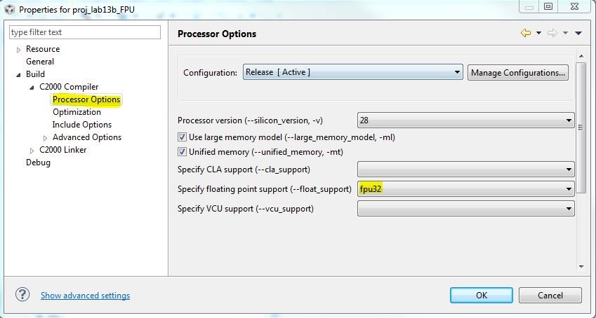

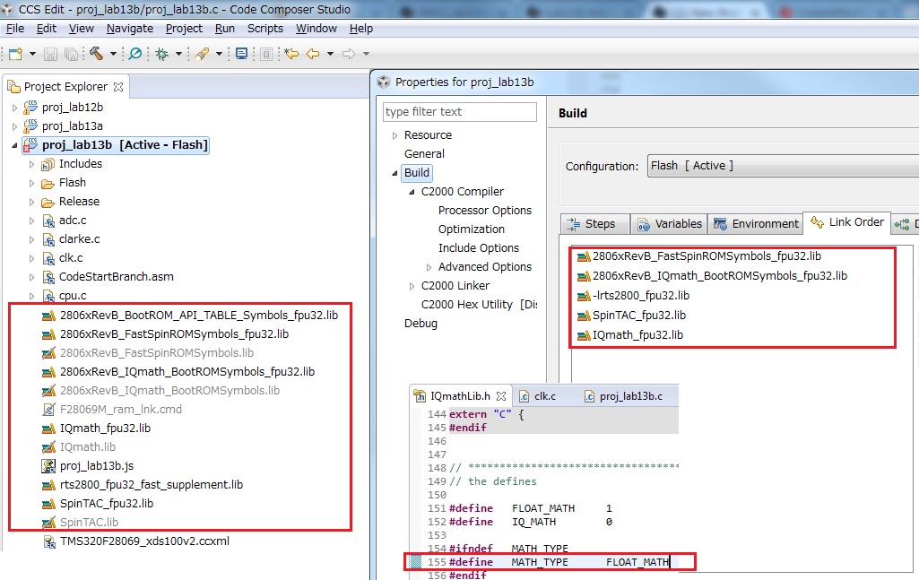

I'd like to change Lab13b to FPU32 based project.
Could you teach me this procedure?
Now, I replaced "32b lib" with "fpu lib" and Link Order and MATH_TYPE as below, but got  compile error(error_log.txt).

    You need to activate FPU in project setting as below except changing all libraries to fpu32 type you've done.
    Also please make sure that InstasSPIN rom codes are still using fixed-point and IQmath inspite of FPU mode, so you have to keep MATH_TYPE as IQ_MATH. In addition to project setting, some monitoring codes for float variables in gMotorVars should be changed as attached lab13b_fpu.c file. Please find updated lines in updatedGlobalVariables_motor(). The one more import thing for FPU is a link order. This 2e2 hepls for link order (https://e2e.ti.com/support/microcontrollers/c2000/f/902/p/368361/1462918#1462918 )
    The attached lab13b_FPU sample project is revised one for lab13b with FPU in boostxldrv8301_revB.

    Thank you for your quick response.
    Build was successful when I changed MATH_TYPE as IQ_MATH !
    It was very helpful !
    Sasaki
