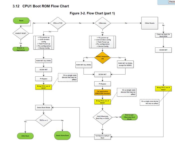

please we are designing a SW  using M0  to  pass paramaters  after a Watchdog reset : we used in the past sma trick on F2806x  and it was OK .
so basically after the Watchdog  reset you run BootROM and then check these datain M0  to perform proper actions .

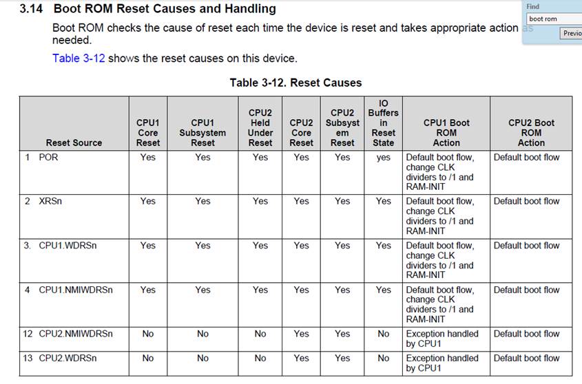

Now in F28377D   I m on CPU1  and  I see after a watchdog reset ( I wrote a wrong value in the Reg )  that M0 is inizialized at 0   and this is true for all memories  ( INITDONE  are "1" for all memory section )
now I checked in DS  and  it is not  clear to me :
in table  3.12   it seems you can skip M0 & M1 inizialization  as per the flow chart ,  in Table 3.14  it seems not feasible  ( both tables attached ) .
please where am I wrong ?
what to check  to be able NOT to inizialize  M0 and M1  after a watchdog reset ?
