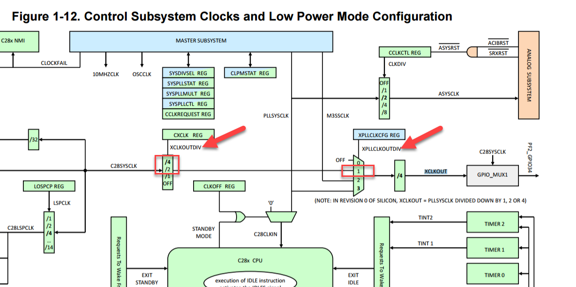

I tried to give control of the XCLKOUT pin (GPIO34) both to the M3 and C28. However I always get a quarter of 125MHz, say 31.25 MHz, at the XCLKOUT pin.
Is it possible to get a lower output frequency than 25MHz at XCLKOUT, without changing the 125MHz?

  • Hi Karlheinz,
    The information I am referencing can be seen in Figure 1-12 of the TRM found here:
    One way to get a divider greater than /4 would be to set the XCLKOUT to the C28SYSCLK using the XPLLCLKOUTDIV register.  Then use the XCLKDIV register to divide the frequency down further.  See the image below.
    Kris

    I am still confused. How can I change the XCLKOUTDIV in the CXCLK register? According to the green color in the figure, this should be done on th C28 side. How can I change this register in software? The SysCtrlRegs structure (taken from ControlSuite) does not have this register (0x7010). Must it be changed by the M3 software? If yes, how can I do it?

  • Hello Kris,
    I did some more measurements...
    Both cores are running at 125MHz.
    If the pin is controlled by the C28 core and XPLLCLKCFG register is set to 0x01 then I get at GPIO34:
    31.25MHz if 0x7010 is set to 0
    62.5MHz if 0x7010 is set to 1
    125MHz if 0x7010 is set to 2
    High Signal if 0x7010 is set to 3
    The XPLLCLKCFG register does not care. And here the /4 divider in front of GPIO_MUX1 (figure 1-12 of TRM) is not active...
    If the pin is controlled by the M3 core and XPLLCLKCFG register is set to 0x01 then I get at GPIO34:
    31.25MHz if XPLLCLKCFG is set to 3
    31.25MHz if XPLLCLKCFG is set to 2
    31.25MHz if XPLLCLKCFG is set to 1 (content of 0x7010 does not change any behaviour)
    Low Signal if XPLLCLKCFG is set to 0
    So here the /4 divider is always active but CXCLK register is ignored...
    Figure 1-12 does not seem to be accurate... How can I get less than 25MHz out off this pin?

  • Karlheinz,
    Based on my experimentation and your results seem to agree, it seems that the output of the XCLKOUTDIV mux goes directly to the pin, and that the input to XPLLCLKCFG[1] is the undivided C28SYSCLK. I have passed this along to our design team for verification. I will get back to you as soon as I have an answer.
    Kris

  • Karlheinz,
    Thank you for the information. I have confirmed with our design team that the implementation is different than the diagram in the TRM.
    Here is a diagram I very quickly marked up to make the implementation clearer:
    As you can see, with these options the maximum divider on XCLKOUT is going to be /4 which is going to be 31.25 MHz in your case.  Is it a requirement for your application to have XCLKOUT under 25 MHz?
    I have filed tickets for both the C28x header files and TRMs to be updated with our findings on their next release.  Thank you for your patience while we get this corrected.
    Kris
