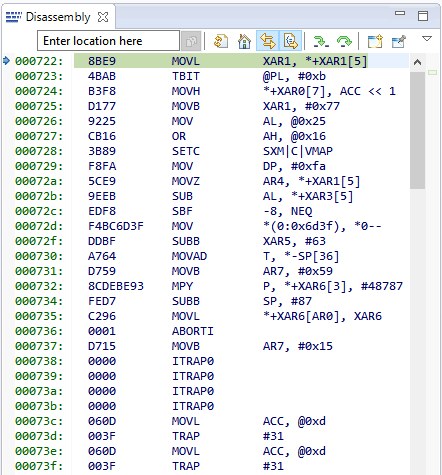

  • Dear Vishal.
    I debug this code in FLASH, and...
    ... I am going to calculation FIR16_DC, and...
    ...jumping to here. It is infinite loop (from 0x000724 to 0x00072C)
    What is this location? I never specify this addresses.

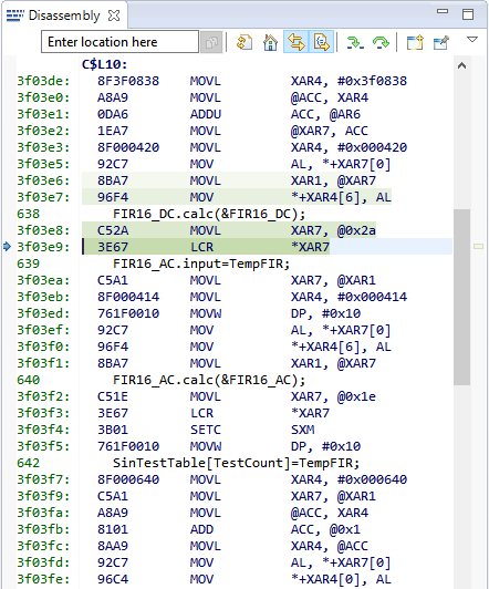

  • Hmm, so it looks like XAR7 contains the value 0x722 just before LCR (the call to the FIR routine). So two things to check for
    1. check the value of FIR16_DC.calc - it should hold the address of the FIR routine. go to that location in the disassembly window and make sure the FIR code is there
    2. MOVL XAR7, @0x2a is acutally loading the value at address (DP*0x40 + 0x2a) i.e. the data page pointer times 64 words plus the offset. This address should correspond to the location of the object element FIR16_DC.calc. So make sure the DP pointer is pointing to the correct page, ifs it not then this instruction is loading the value at the wrong address.
    If you find that point #2 is the problem then my follow up question would be - do you have DP load optimization turned on? if yes then does turning it off fix your problem? if it does then please let me know as this might be a compiler issue.
  • Vishal,
    Yes, you was right. I have the wrong address, because I specify FIR16 FIR16_DC=FIR16_DEFAULTS; in initialization function (look at the my second message). When I specify it in header - it all ok.
