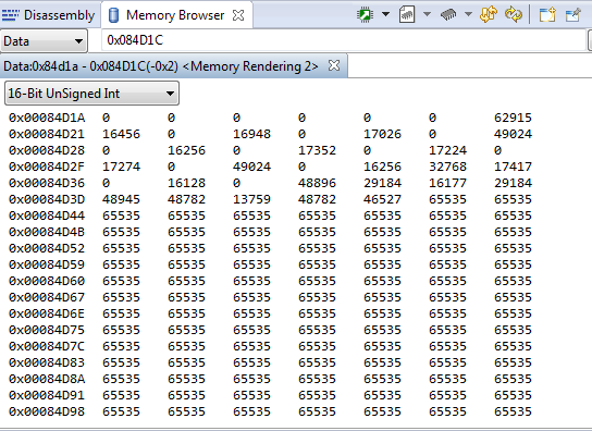

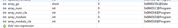

I have initialised some global variables in my own .c file as follows:
int16 array_index = 0, array_modulo = 0, array_num = 0, tempI = 0, array_index_cla = 0, array_modulo_cla = 0, array_num_cla = 0, tempI_cla = 0;
All these are global variables, so I should be able to update them in watchwindow. But I cannot edit the values which has @Program in the Address column. However, the other values which has @Data is the Adress Column can be edited.
Also I get this error message:
IcePick_C_0: Trouble Reading Memory Block at 0x0 on Page 0 of Length 0xc8
Please let me know how to resolve this issue.
I recently modified my cmd file to make space for CLA Program and I don't know if that might have caused this problem. So I have attached my cmd file also.

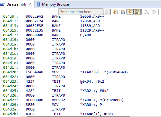

  • Prakash,
    Looks like those variables are sitting in FLASHB in page 0 --- which i doubt is the correct address. are these global variables? if so, can you check their address in the .map file.
  • Hi Vishal,
    Yes, they are global variables (declared and defined in my own .c file and not in the main.c file). Please check the Memory map below:
    As you can see, all the Rows with ITRAP0 are not accessible in watchwindow. Also, I don't know why is there ITRAP0. Please provide a solution.

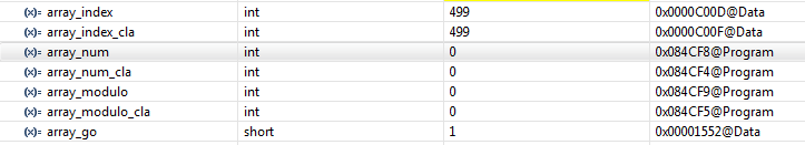

  • Hi Vishal,
    Previously the global variables were Initialised, now I uninitialised them, so that they will be stored in .ebss instead of .cinit. This solved the problem, now I can edit those Data in watch window. I have attached the updated CMD file.

    But why can't I have initialised global variables that can be edited in watch window. What is causing this issue?
    I dont think its .cinit. I was going through the assembler guide (SPRU513), section 2.2.1 and it seems that initialized non-const globals go into .data, which you have not assigned in the linker command file. globals that  are consts go into .cinit which may be what you were seeing.
    When you dont initialized the globals go into .ebss. Now if you are initializing the globals (non-const) and you dont have a section placement for .data in the linker command file you should get a link time warning stating that you are missing a section definition; the linker will then put it in the first available memory.
    You can check the .map file to see the exact address placement for the global variables.
