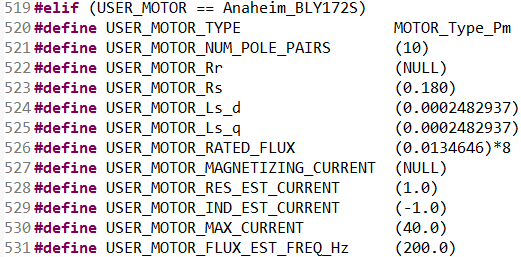

    Here is a picture of our user.h files, we use the example programm proj_lab04.
    It is simply unusual that the speed does not increase although we increase the cross current Iq massively. Is there maybe something with the frequency?
    With friednly greetings
    Marco
  • I don't understand the *8 you have used in the flux. I'm actually surprised that compiles correctly.
    also (200.0) is too high for the EST_FREQ
    You should use between 20-60 Hz for most motors
    can you please run proj_lab02c and provide the results of motor iD?
    make sure the motor starts spinning during RampUp state and keeps spinning for the duration of the ID process.
    if it stops spinning increase RES_EST_CURRENT until it spins throughout.
    after we have verified the motor parameters please use proj_lab10 to run the motor. this lab lets you view gMotorVars.Vs and Is which will tell you how much of the bus voltage and USER_MOTOR_MAX_CURRENT are being used, which will be important in debug.
