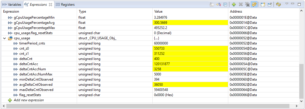

TMS320F28027F: proj_lab03b: 500k% CPU usage??
Part Number: TMS320F28027F
I'm trying to measure the CPU usage using proj_lab03b on TMS320F28027F, and the given variables that are supposed to show percentages are showing exorbitant numbers (see screenshot). The search of the project doesn't show where the maxDeltaCntObserved variable is set. CPU_USAGE_getMaxDeltaCntObserved() just returns the value from a structure. So I'm wondering, what is it I'm actually measuring, and how do I get percentages?
  • maxDeltaCntObserved is set in CPU_USAGE_run() function in cpu_usage.h, and the percentages is calculated in updateCPUusage() function in proj_lab03.c.
    You need to change the codes in proj_lab03.c as below beacuse you need to set timer period of CPU_USAGE is equal to cpu timers 1 is HAL_setupTimers() in hal.c.

    Please check HAL_setupTimers() in hal.c whether is as below.
