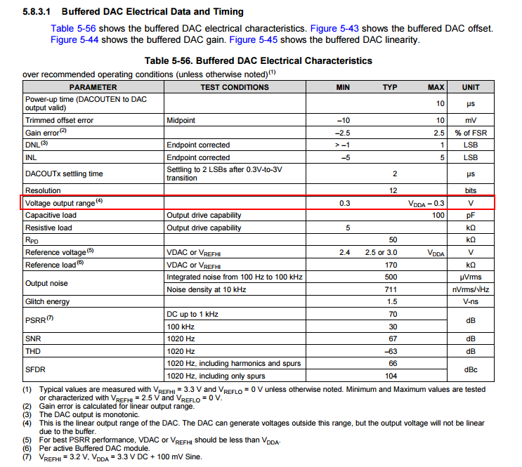

I've gotten the TMS320F377S, I wonder if the DACs on chip are able to implement 4-qradrant multiplication. 0-10 V or -10V to +10V output are required. I can't figure out the solution from instruction manuals. The DAC8811 is able to implement the function.
  • Hi Jingtai,
    The on chip DACs range are set by VSSA on the low side and the DAC reference on the high side.  The DAC high reference can be either the VREFHI pin or the VDAC pin.  In both cases, VREFHI < VDDA is required at all times. (VDDA is nominally 3.3V)
    There is also a further limitation on the linear output range of the DAC:

  • Hi Jingtai,
    The output of an on-chip DAC is a voltage and not a current and the DAC reference input has a relatively narrow valid range, so I don't think it would meet the definition of a multiplying DAC even with external circuitry.
    However, if you just need a bipolar output you could certainly build an op-amp circuit on the output to transform the DAC output voltage range into whatever voltage range you desire (but this won't use the same topology presented in the DAC8811 datasheet).
