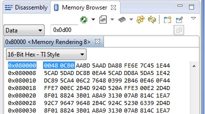

However, when I flash the program in CCS and look at 0x0008_0000, I don't quite see the right address for c_int00:
Am I missing something?
Thanks, dave
  • The picture of the debugger didn't post above.  Here it is showing the address 0x004b_0cb0 written to 0x0008_0000:
    I see the correct value (0x80CB0) at 0x80000 address location. Are you running it standalone or with CCS connected?
    Vivek Singh
  • Yes, I'm using CCS to write the program into flash. I can disconnect the launchpad from the PC, then reattach and view 0x80000 and still see 0x0048_0cb0.  Of course, when I try to run the program without CCS it never gets to c_int00.

    I looked at the C28 instruction set PDF, and it explained the difference in the address.  The LB instruction is 0x0040_0000 plus a 22-bit address, so that's okay. It appears that the program is written to flash correctly, because I can connect the board to the PC, attach the debugger and the program will run without loading it.  I just haven't figured out why it doesn't branch to 0x0008_0000 when running from flash.
