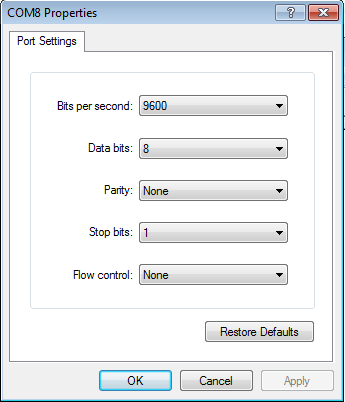

  • Hi Cody,
    thank you for coming back to me. I am not quite sure if we talk about the same thing. To me, it seems much more an issue with entering the ISR rather than whatever happens within the ISR.
    In particular, the SCI user guide says on p. 21:
    "If the RX/BK INT ENA bit (SCICTL2, bit 1) is set, the receiver peripheral interrupt request is asserted when one of the following events occurs:
    – The SCI receives a complete frame and transfers the data in the RXSHF register to the SCIRXBUF
    register. This action sets the RXRDY flag (SCIRXST, bit 6) and initiates an interrupt."
    So, when using HypterTerminal, I would expect the ISR to be called every time I hit a key and the content is written to the SCIRXBUF register.
    Is my understanding correct?
    If yes, why do I need to hit the key 17 times until the ISR is called? I set a breakpoint in the ISR to see when I enter it. And it happens after hitting the key for 17 times.
    So I believe that there is a fundamental mistake in a setting (in my code or maybe even in HyperTerminal?). I use 8N1 and set the settings in Hyperterminal according to the picture I uploaded.

  • Alex,
    I have not closely gone over you code, but it looks like you have setup the FIFO enhancements. This means that the value in RXFFIL4–0 will determine when an RX interrupt is asserted. Reading section 1.2.10.1 "SCI FIFO Description" in the SCI users guide should hopefully help you. You can also find a description of RXFFIL4-0 in Table 2-10 "SCI FIFO Receive (SCIFFRX) Register Field Descriptions" of the same document.
    Hope it helps, and let me know if you have anymore questions.
    Cody
    In initialization, set SciaRegs.SCIFFRX.bit.RXFFIL = 1, so that the mcu enters to ISR routine when it receives 1 byte. Moreover, in ISR, continue reading bytes until the FIFO is empty. it is simply done by adding a code to your ISR like this one:
    while(SciaRegs.SCIFFRX.bit.RXFFST>0)
    //get char (maybe its better to pass incoming bytes to an array, so you don't lose any incoming byte)
    ReceivedChar = SciaRegs.SCIRXBUF.all;
    I hope this will help.
  • Hi Cody and Kadir,
    thank you both for your responses. They helped me in better understanding the UART functionality on the particular DSP. In fact, since I am only receiving the new setpoints for my control from my laptop, I decided to disable the FIFO enhancement and store every incoming byte into an array.
